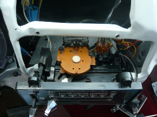

Short update - I took a look at the LMC truck catalog and it shows a climate control light socket and bulb plugged into the back of the climate controls on the upper left side. It should be a black holder with two wires, and you remove the holder by turning it about a 1/4 turn and pulling it out to get to the bulb.

Not a perfect pic but you can see the light socket lying next to the control with the grey and black wires going to it. The socket installs into the rounded area on the right side of the cotrol.
