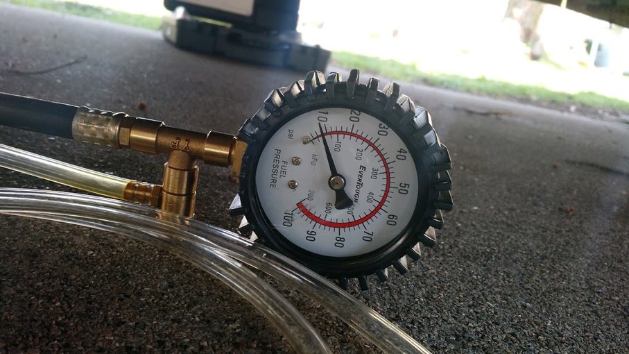

Checked my fuel pressure and its on the low side (8-9 lbs without a load). I know one of my tank pumps is dead so I ordered a denso pump as well. If the plugs and wires don't take care of the stumble, then I'll change the pump a little sooner than later...

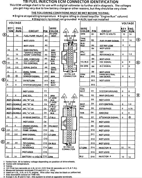

Yeah, it sounds like the pump is gonna have to be done fairly soon. If you want, you can probe the wire coming off the A5 pin on the ECM. It should have zero volts key on, engine off, and it should have fourteen volts engine on. If that wire isn't producing fourteen volts, it's the ECM's fault. Like I said, I've had the ECM work for the engine alright with the diagnostic circuit damaged. I've never had to go digging around in the ECM area of a square body, but I have in a GMT400. You should check to see if there's a ground strap in there for the ECM and how it's looking. I'll attach a pinout for your computer so you can check any of the voltages you want.

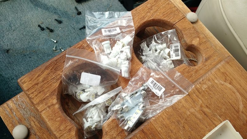

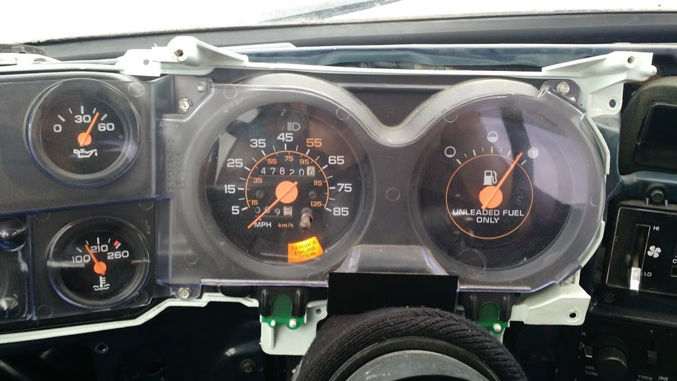

Well I put in some new led dash bulbs and the SES light started working?! I don't know why, maybe just due to the fact that it had been sitting of a while... don't really care as long as nothings gonna mess up later...haha
Stuck a paper clip in it and its throwing a Code 44 error - 02 sensor reading lean condition...

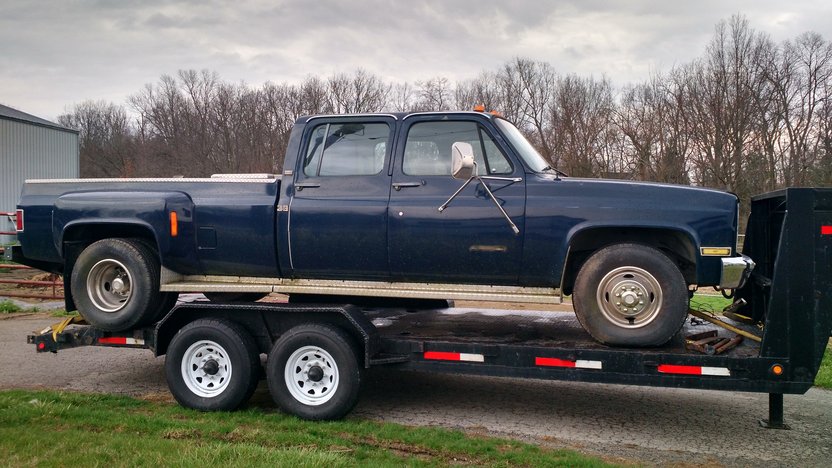

Just in case anyone wondering what we're working on... We all know we love seeing pics! Haha!
