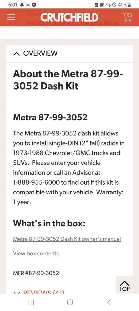

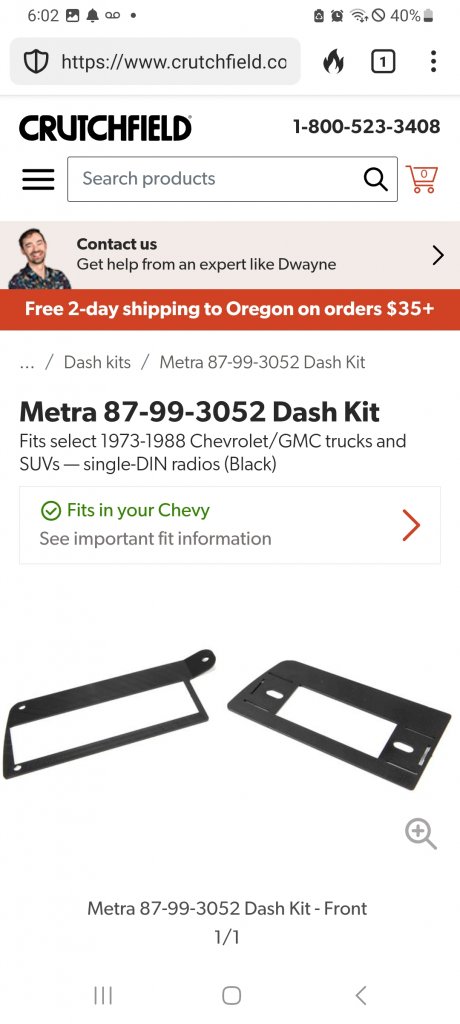

Thank you! For The information on the double din guys, Found this. Thinking it will work maybe?

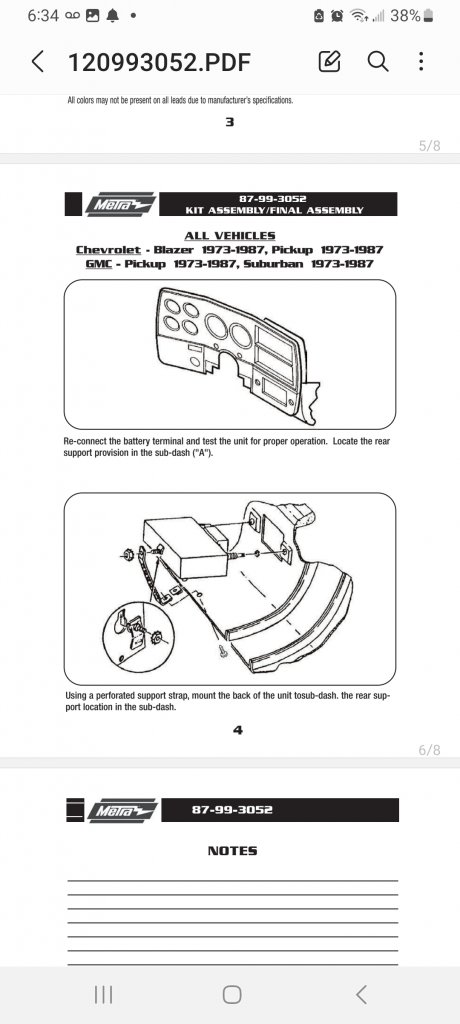

Downloaded the manual to see what it was all about and it Looks like it will fit like a glove! Going to order asap

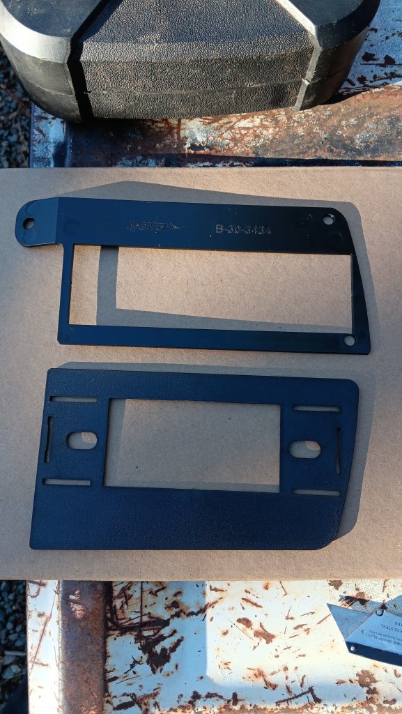

Just ordered the installation kit! Totally going to be worth it! 25$ but now it brings me to my next dash issue. I'm going to fix my speedo finally. Going to put in a mechanical speedo to keep it simple. But some modifications will be needed. Because it's a fode transfer case. Has both mechanical and electrical piggy backed. Wonder if I could get it to jive with my electric speedo? That would be easiest if it was that simple.

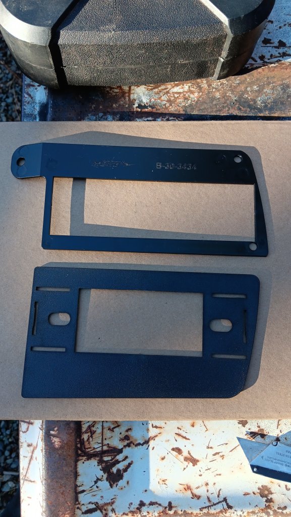

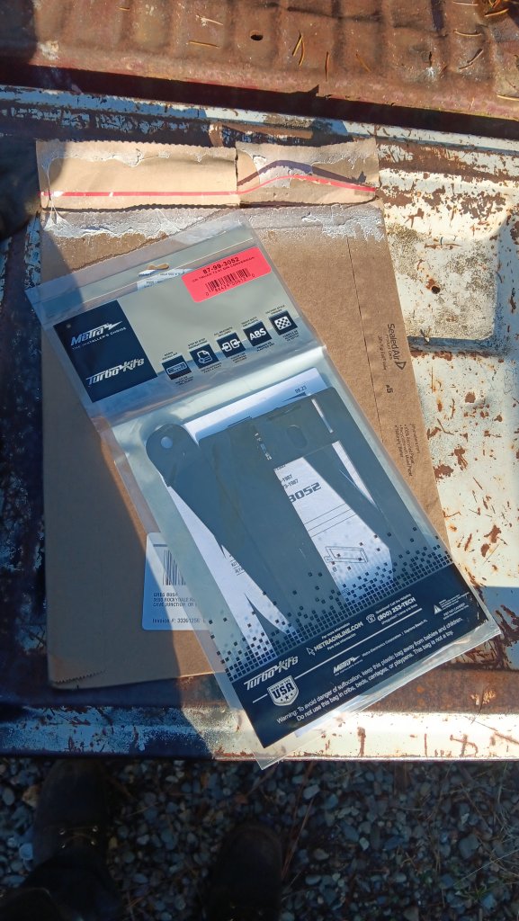

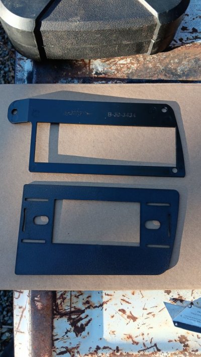

I received my pieces parts today. Plastics seem to be good quality. Destructions look good and are in correct language too! Well worth the money!
