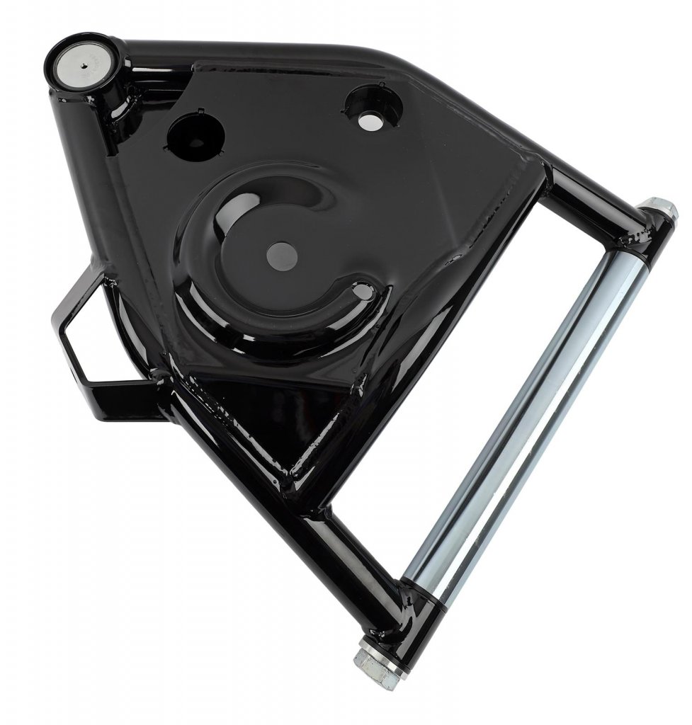

Not much of a journalist, so it might be brutal to write an instructional article? Short version......Square body 2 wheel drives are really fairly simple. More shims, more camber, More shims on the front attaching bolt is more caster, more on the rear attaching bolt is less caster. Usually you add to the front to get where you need to be, but you HAVE to have some kind of measuring device......strings, levels, boards, whatever or you have and alignment machine.....I kept mine from my shop downtown. Still get calls to do alignments, but I stick to the older stuff, street rod/muscle cars, square bodies............more fun and the people are Usually nicer ;) I gotta admit at my age it's easier to tell people to EF off!!!!
