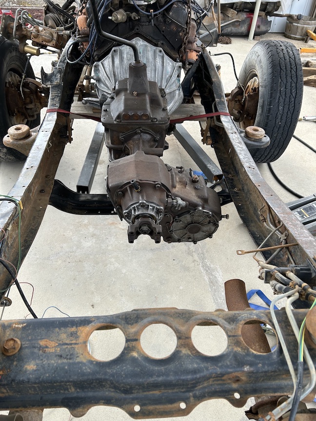

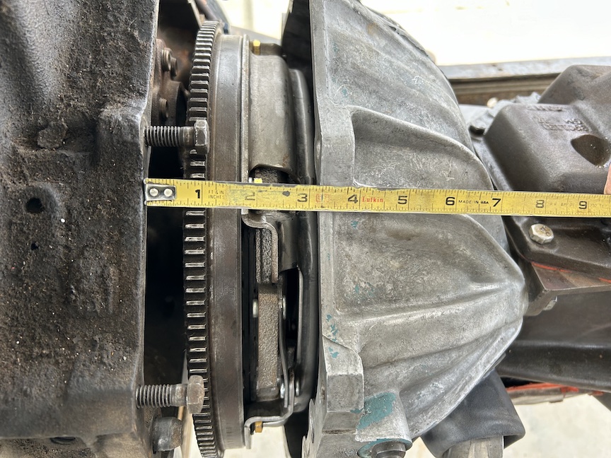

TL;DR: I'm in the middle of body swapping a 1985 C10 cab & bed onto a 1984 K20 frame. The frame was purchased without a front clip, engine, or doors so specific truck options are not known. After decoding the VIN I confirmed the donor truck/frame is a Canadian truck that had a 6.2L diesel, and after reviewing the 1984 GM Info Kit it appears to have had the C6P option. The issues started when we took the SBC 350 out of the 1985 C10 and placed it on the engine mounts of the 1984 frame in conjunction with the SM465/NP205 combo (the trans/tcase duo were purchased separately from either truck, and the exact years are not known). There is a near 3 3/4" gap between the back of the 350 & SM465 bell housing (see sbc350_sm465_gap.jpg). The trans crossmember is in the factory location with what appears to be the correct mounts – when comparing the 6.2L diesel engine mounts and SBC 350 engine mounts, they appeared to be the same so we used the 6.2 mounts in the location they were in. Are there any red flags as to why there would be such a large gap between the engine and transmission?

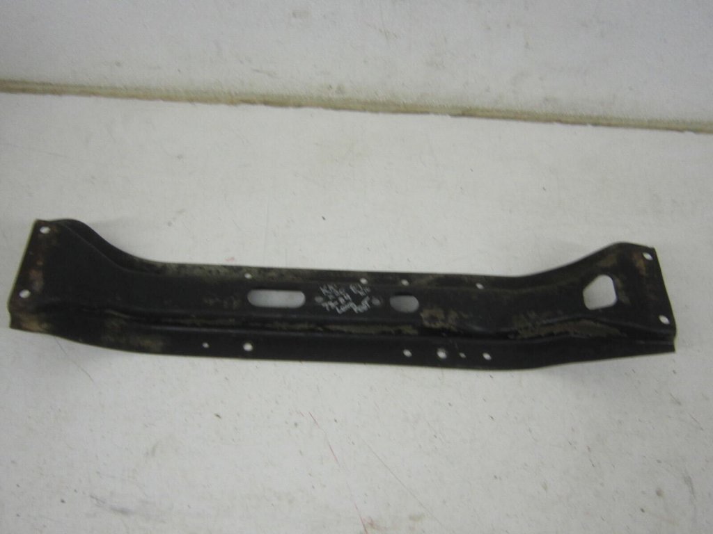

- My second thought was about the transmission crossmember. The crossmember that came with the SM465/NP205 duo had a smaller bolt-hole width on the sides that didn't fit the frame. I ended up buying a 1984 crossmember with the 4" bolt-hole spacing we needed (see crossmember_1984.jpg & np205_crossmember.jpg). The trans/tcase mounted well, and it went right onto the frame, so it seems to be a good fit, but not sure if that might be part of the problem?

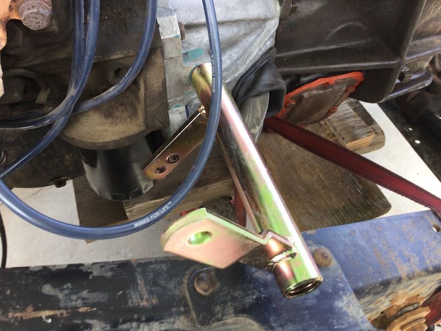

- For now we've drilled new holes in the frame & moved the trans/tcase foward to mate to the engine. In doing so it seems to fit nicely as far as matching the factory position for the clutch bellcrank to the frame (see clutch_bellcrank.jpg). We're currently missing the clutch pivot ball seen missing in the pic, but we should have that soon. The pic is mainly to show that it looks like by moving the trans/tcase forward the 3 3/4" to fill the gap, it fits more in line with where it may need to be based on frame markers. But even still, it's odd we'd have to drill new holes for the trans crossmember.

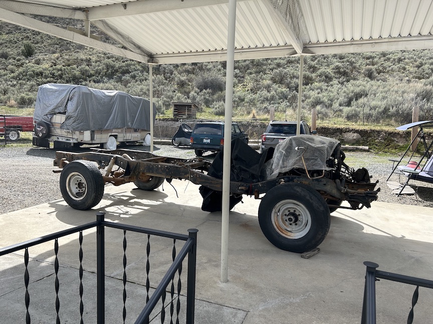

- The next thing that is odd is that the VIN decodes the donor frame as a 1984 frame (see frame.jpg), but when comparing the frames in the CKRV Parts & Illustration Catalogs for the '84 & '85 years (2 separate catalogs), it looks like the frame is actually a 1985 based on looks alone? I found the plant sequential number on the top of the right frame rail and it matches exactly to the last plant sequential numbers of the VIN, which tells me that frame came with the cab sold as a 1984. Is it possible that it was manufactured late in '84 and left with early '85 parts? The glove box has a 1979 date on the bottom outside (even though the VIN sticker on the inside is 1984), and it looks like the date months that are scratched off on it are September thru December, which would fit the theory of the 1984 truck leaving the factory with early '85 parts. Just a thought...

My first thought is that the mounting location for the engine is wrong. If you have the capability I think you should attempt to place the cab on the frame horns to see what the clearance is from the firewall. That will be pretty telling for if the engine is located properly. You can use an engine hoist with a wood cradle to move the cab around. That's how I did it.
If the engine is in a good spot it's not a big deal to just drill new holes for the cross member to make it work.

The engine looks properly indexed to me. The engine mounts should be the same. The biggest factor of transmission crossmember hole location would obviously be trans/transfer case combo. They do not all line up the same. I've never looked into it but I would say the 465/205 combo would be that almost 4 inch difference, compared to an automatic. 465/205 is going to be the shortest combo available.

FWIW big block,small block, 6.2 diesel, all the motor mounts were in the same basic location,there was a difference in height of about an inch between small block and big block,but if nobody told you,you wouldn't know,because it all still bolts up and works. You'd have to try to locate the engine wrong,it won't happen accidently.
