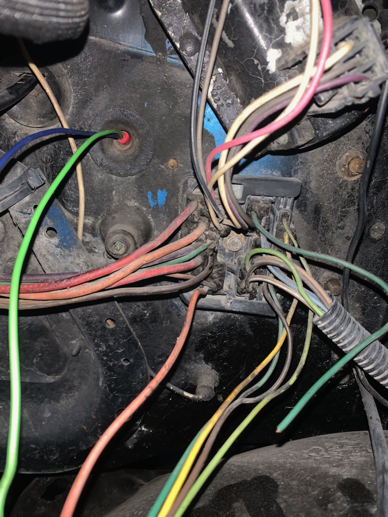

I have a Frankenstein unit, registered as 1981 K1500 however, I find new surprises every time I try to fix or improve something. Currently I have her in parts and no garage. I am trying to be back up and running before winter hits. Any help would be greatly appreciated. I will add photos after work today. Only owned for one year. Just getting into things slowly. .... well that was the plan till one thing leads to next thing and here we are, it all started with taking box off to fix some rust.........
So here's the quick short story, New rear wiring = all lights, sending units, selector unit and reverse switch. Followed wires and installed cleanly.
When in the fuse panel seen cut wires taped off = Interior lights and smoke lighter so I removed them and cleaned up any bad connections.
All new dash lights tested before put in cluster, fuel gage did work before, truck is firing no problems with fuel wires
Now my fuel gage doesn't work at all ....well nothing in my dash is working any ideas? the buss bar was removed it wasn't connected to anything but cut bits.
Do I have to install the buss bar to get my dash to work, can I bypass it somehow, or am I missing something completely different?

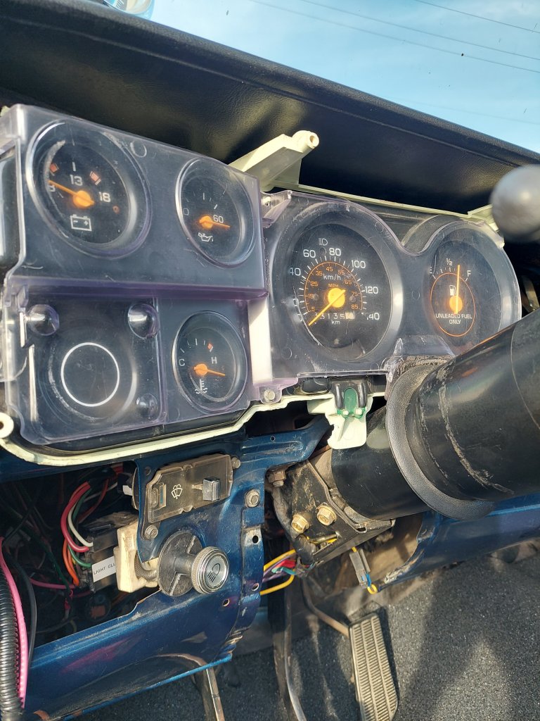

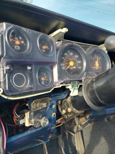

When I got home got right back at it. I removed everything from its home and started trying different things wiggle this, change that light and here is what I found.
The light with ground wire from ashtray area must be plugged in to top fuel gage light location ( top right of gage cluster )
The dimmer switch needed to be cleaned and (played with) seemed sticky/glitchy
Ta Da gage cluster works .....no signal lights .....but flasher is trying, so good.....

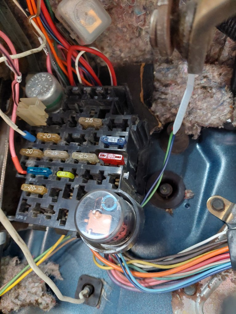

Place hand behind flasher and wiggle ....TA DA so I am thinking the fuse panel and or bulkhead connector need repair or rebuild to secure wires, I am learning as I go and keeping this unit stupid simple lol no bells and whistles just enough to enjoy the drive. If its not needed to drive I do not want it.
Here are some photos of what I have now, should have seen what I started with.
Thoughts or suggestions?

also whats with the mini fuse?
Note, not all my fuse spots there were populated since I pulled fuses for things not being used since I wanted to limit the possibility for shorts since my wiring has..... less than ideal routing in places.
I forgotwhat all the wires that clip into the fuse block do, but you may be needing some of them since they look like they are power circuits, the one even says LPS with an arrow on my block there
