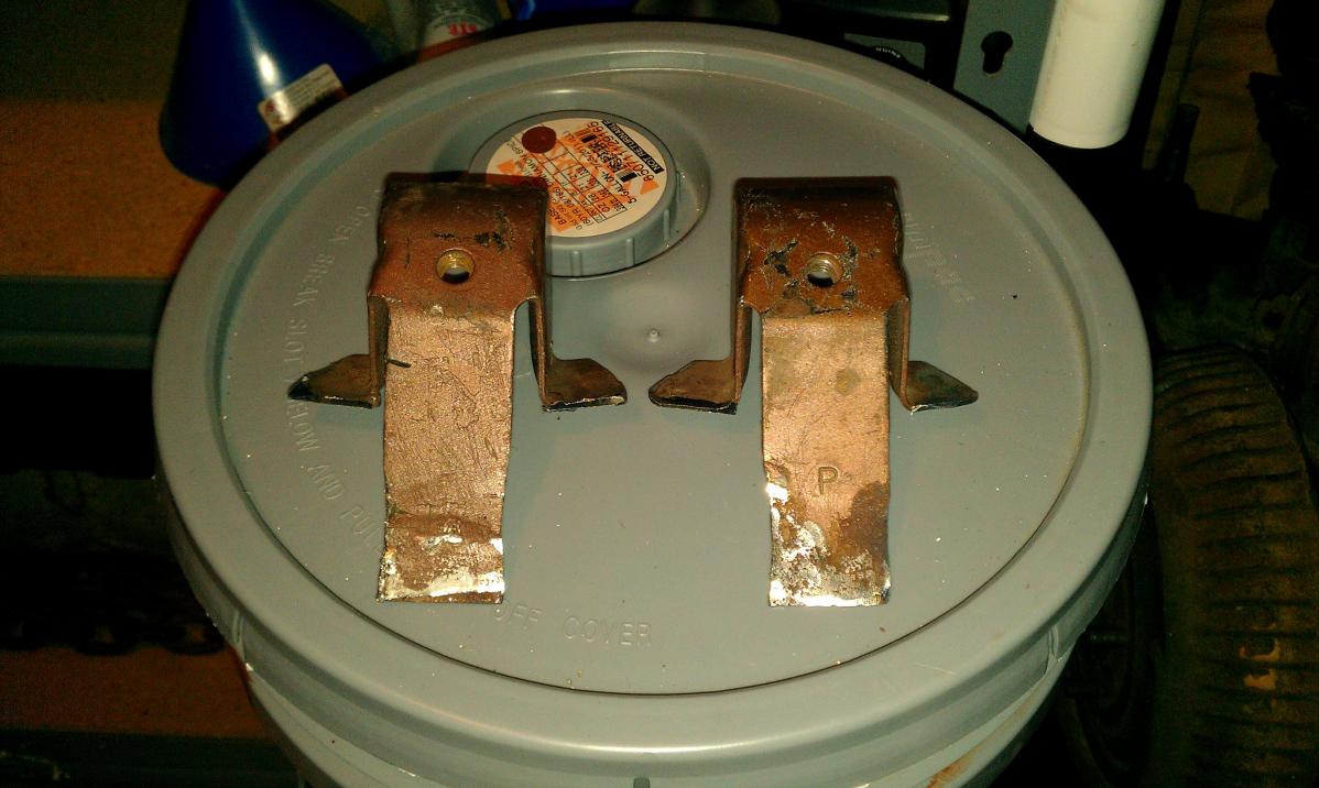

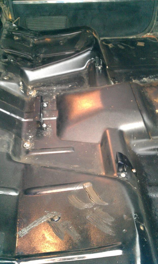

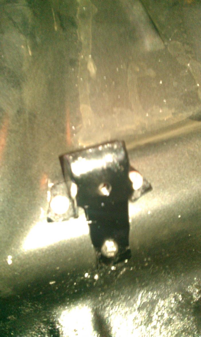

I would try to use a pair of squarebody bench seat brackets and add a burb seat perch to the floor. Should be a fairly easy mod to atatch to the camaro buckets.
