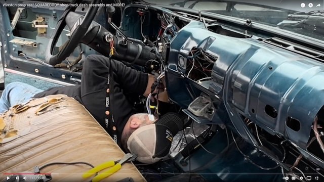

You may be looking at the ignition switch on top of the column, near the firewall. The brake switch is pressed by the brake pedal arm and is easily removable just by standing on your head like this:
I thought this photo (From Hammers Garage on you tube) was hysterical. How many of us have done this?
No, you don't have to do all the disassembly shown, but you do have to get under the column to see it.
