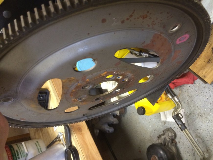

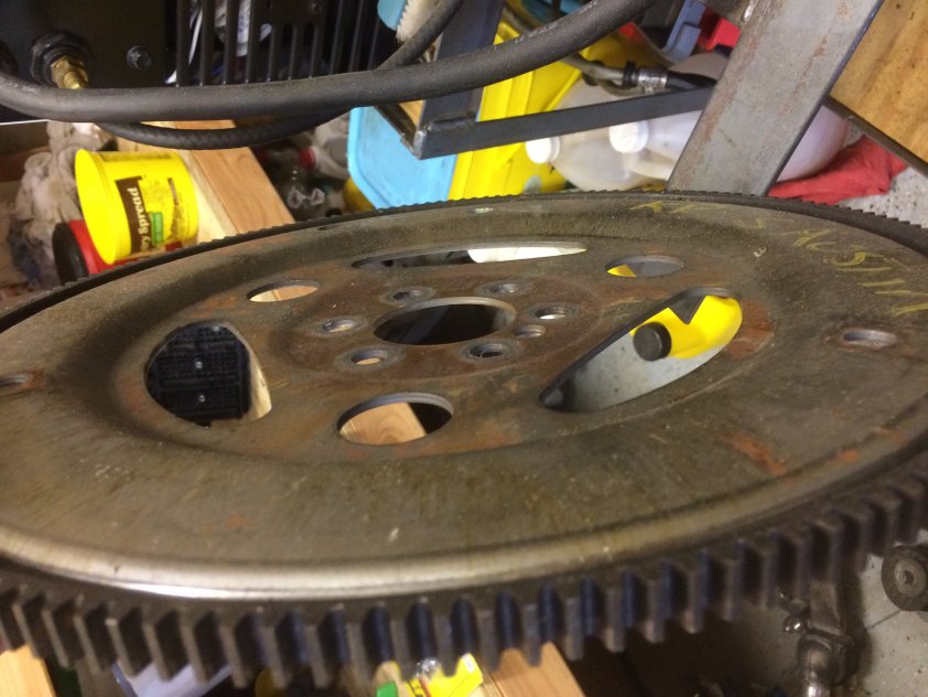

Alright, here is the dished 5.3L flex plate. If this is the flex plate you have, you'll need the flex plate and spacer kit from PACE. Otherwise, you should be good. You can always double check and see if you have a spacer behind the flywheel already, if you have any doubts.
