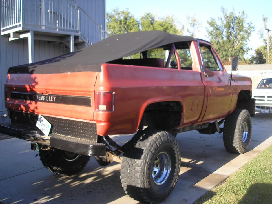

How I covered mine!

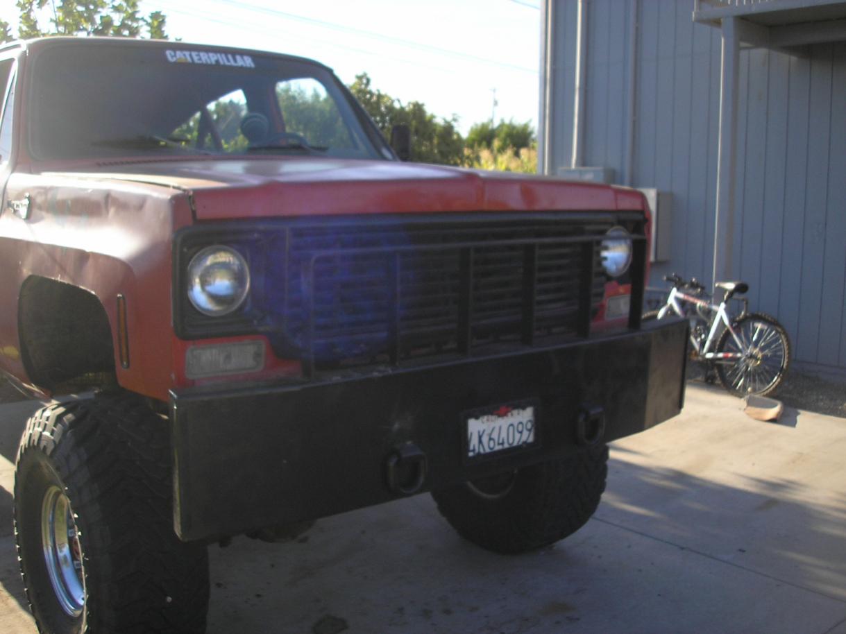

You just fab up a haif box sort of thing and use all the stock frame holes for your box , then bolt your bumper on the top of the box you made 3" higher ,( kind of hard to explain ) , I will try to get some pic's for you. It's also real easy to raise the saddle tanks as well. Just drill new holes in the mounts 3" lower and use the stock frame holes.

Here is some pic's of what I did for the front bumper and raised the tanks (super easy) , just need some paint , steel , and a nice wire feed .
