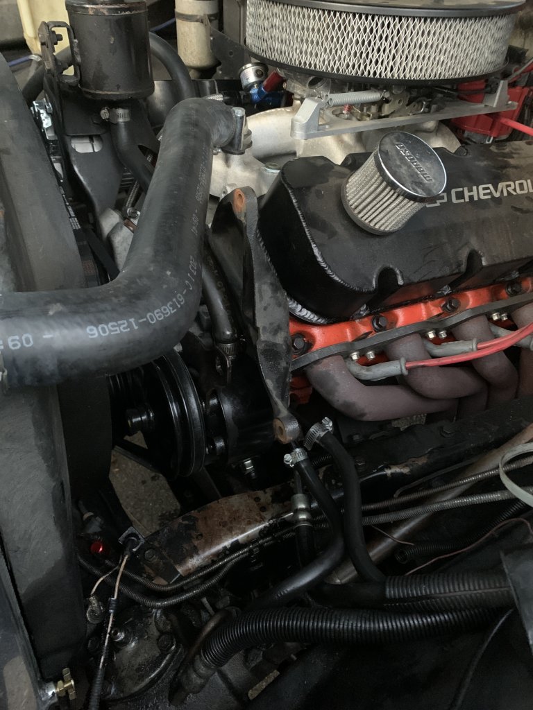

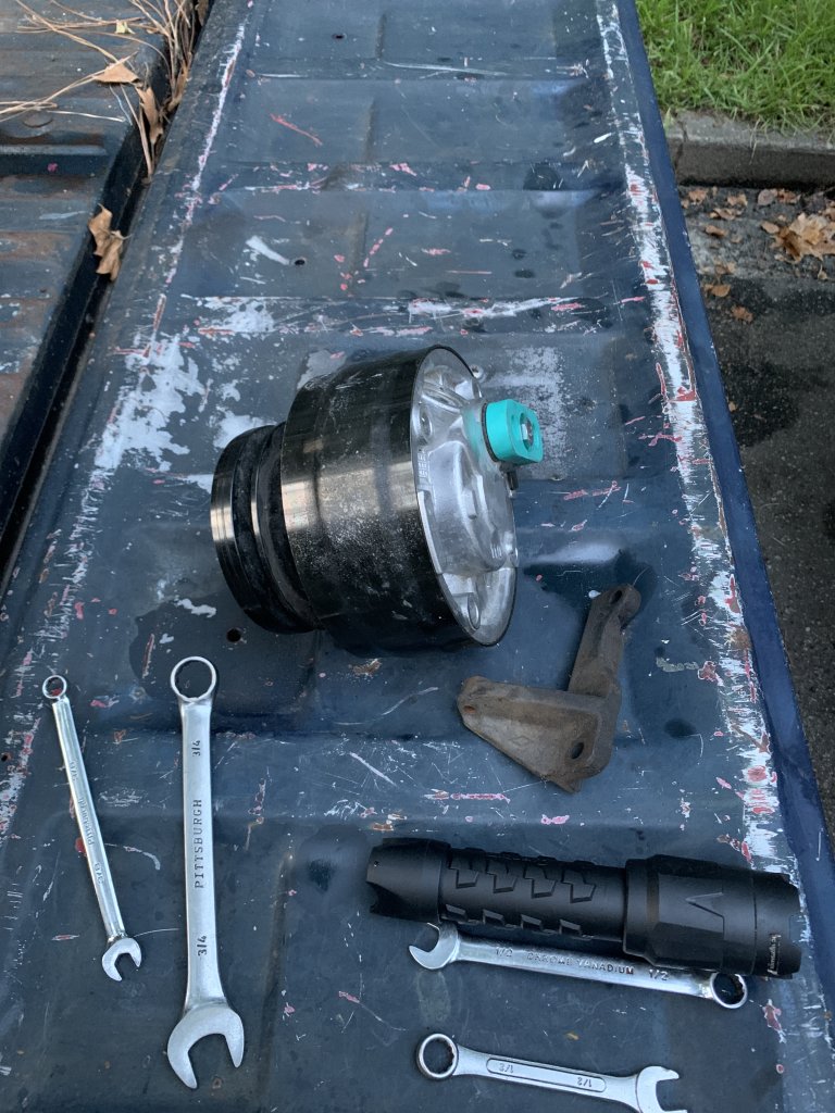

Looking for help identifying what I have & what i need for ac brackets. It’s a 85 c30 454. Pics below of bracket & compressor I have. If anyone has similar set & can post pics, part names, part numbers? Would be greatly appreciated. Thnx

That's an R4 compressor. The big blocks didn't use an R4 compressor until the serpentine belt setup in the later years. The new body trucks got them in '88, I believe the squarebody trucks got them in '89.

Ok appreciate the help. Sounds like I have the wrong compressor. It should have an A6 is that correct?

There were a couple compressors used in the 70's and 80's, but I don't remember if they use the same bracetry or not. I'll dig up some pictures of my old '86.
