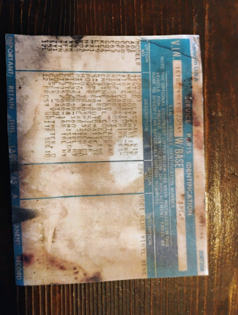

Hello everybody. I'm trying to figure out what the gear ratio is on my 84 base model 3/4 ton Sierra is. The SPID says GQ1 Rear Axle - Standard. I tried finding it online and the GQ1 isn't listed. Can someone help me out with this please? Engine is a 350, and the trans is a TH400. I'm hoping they are something for daily driving, and highway use once in awhile.
Thanks

Or pop the rear cover and count the teeth/find the numbers on the ring gear to verify. If you haven't changed the gear oil in your ownership it's probably time to do so anyways. Gear oil is cheap compared to rebuilding a rear axle.

Just to flesh it out a bit more: I see C20903 W LT9 with the three speed auto (non overdrive = MX1) so I'd call it 4.10:1.

Correct. For base axle GQ1 the SPID shows GQ1 but doesn't specify the numerical ratio, because it varies (as shown on the Powertrain Chart).
For an optional ratio: The SPID will show the RPO and call it out by name (ie, GU6 = 3.42, GT4 = 3.73, GT5 = 4.10 or whatever).
