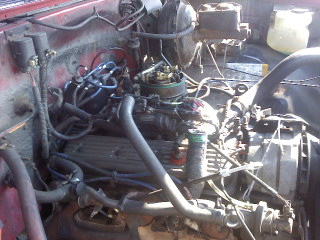

Anyone know what these modules or relays do

im not sure what these modules or relays do they are in the upper left of the pic next to each other also have a little problem with the manifolds turning cherry red and oil pressure dropping below 30 then back to 30 it also smells like it is running rich

The one on the left should be the fuel pump relay and the other one should be the transmission kickdown relay (if you have a TH400).
Or maybe the other way around. Whatever, the kickdown switch should have only 2 wires.

ya i have the th400 thank you
