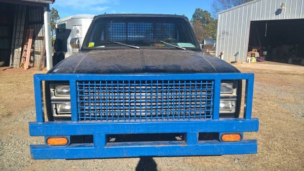

Eeekkk!
This is what I see in my mind's eye and i'm like - ewwww.
It's for sale in the OKC Craigslist -$150.
Eww.
Holy crap that's nasty.
Eww.
That's horrible and should be illegal. If loud exhaust is audibly desturbing the peace then that thing is visually disturbing the peace
