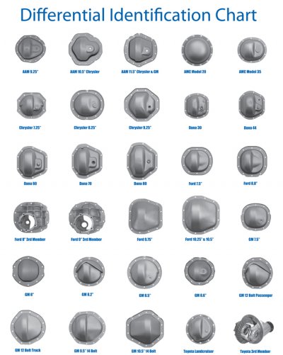

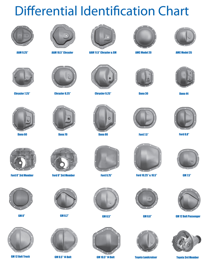

As you can see below... the Dana 44 is not as oval round as the GM 10 bolt.

you could have EITHER a Dana 44 or a 10 bolt between 78-81ish. My 1980 has a 10 bolt, there is another thread on here where an original 81 heavy 3/4 ton has a Dana 44 front. The only way to know what you have is the case shape and the stamped code on the axle tube

@boltbrain Google for 10 bolt front axle pics, you'll see that the belly of the housing has sharp ears that hang down at the lower outer corners (maybe 1-1.5" square). The 10 bolt cover will also be fairly round (not perfect) all the way around whereas a D44 cover has straight sides with a rounded top and bottom.

Thank you, definitely a Dana 44. Now I can shop for a knuckle. There was nothing but a pile of rust inside the hub when I bought it. The PO just left it engaged all the time as it never left the ranch. I got the cap, two snap rings and two round things out but the washer with the square gear like shape won’t budge. I tried heat, drilled and chiseled it in half, but it’s still not moving. Rusted to the washer behind it I guess.
