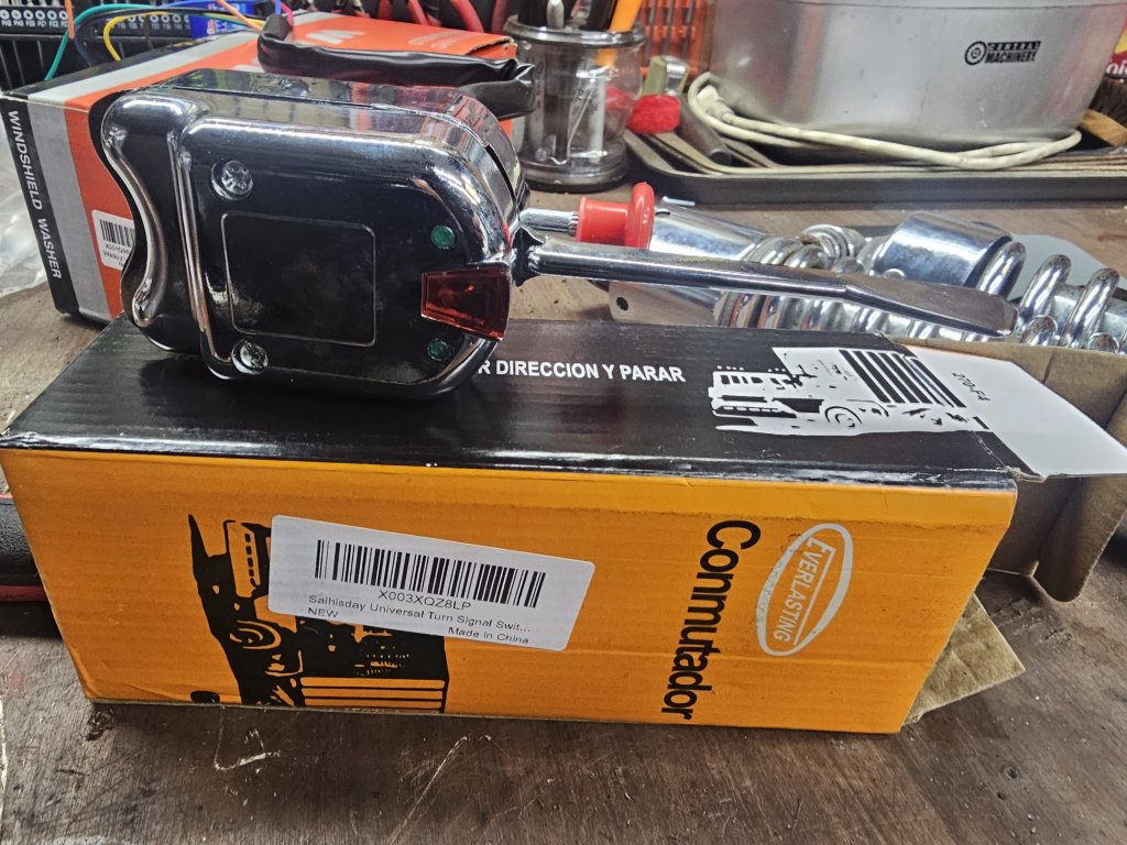

So I decided to get my turnsignals working after about a week of hors and middle fingers from my lack of signals. Opened the column to a mess. The plastic was all busted, because its almost 50 years old, and the wires were coming out. I bought the aftermarket signal lever off Amazon and wanted to hook it up. Problem is, I don't know which wires go where and having an issue finding a wiring diagram that shows me just the signals in the steering wheel. Does anyone have said diagram, or know off hand what colors go where? Thank you for any help.

It was already busted up. Lever was broken. I've used these on other builds, so figured I'd use it here.

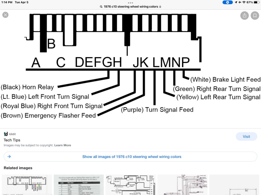

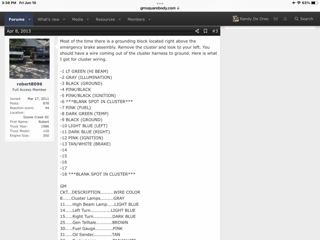

new turn signal switch at local auto parts store about $55 and easy to install. here is plug set up that might be close to your application.
