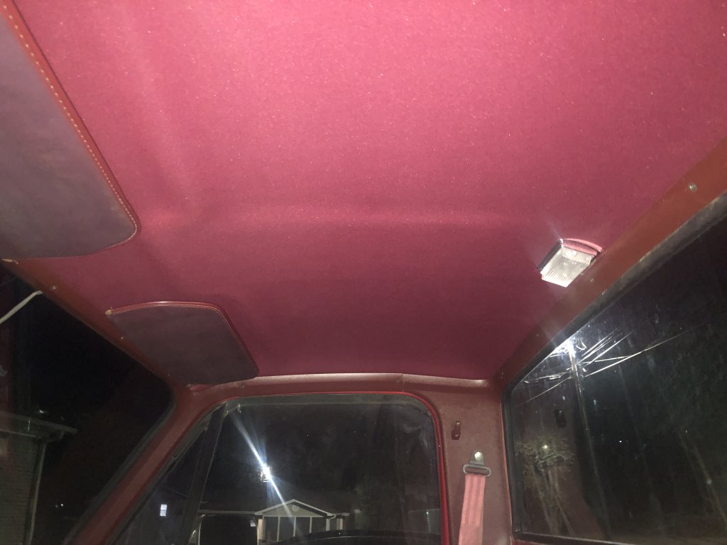

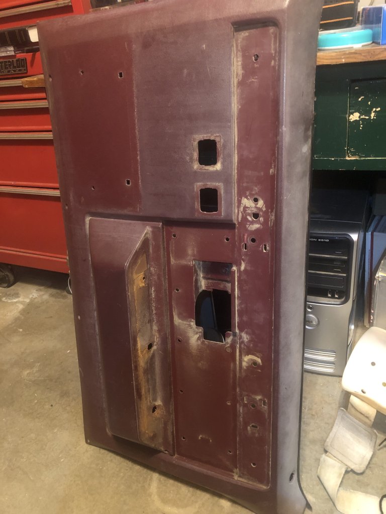

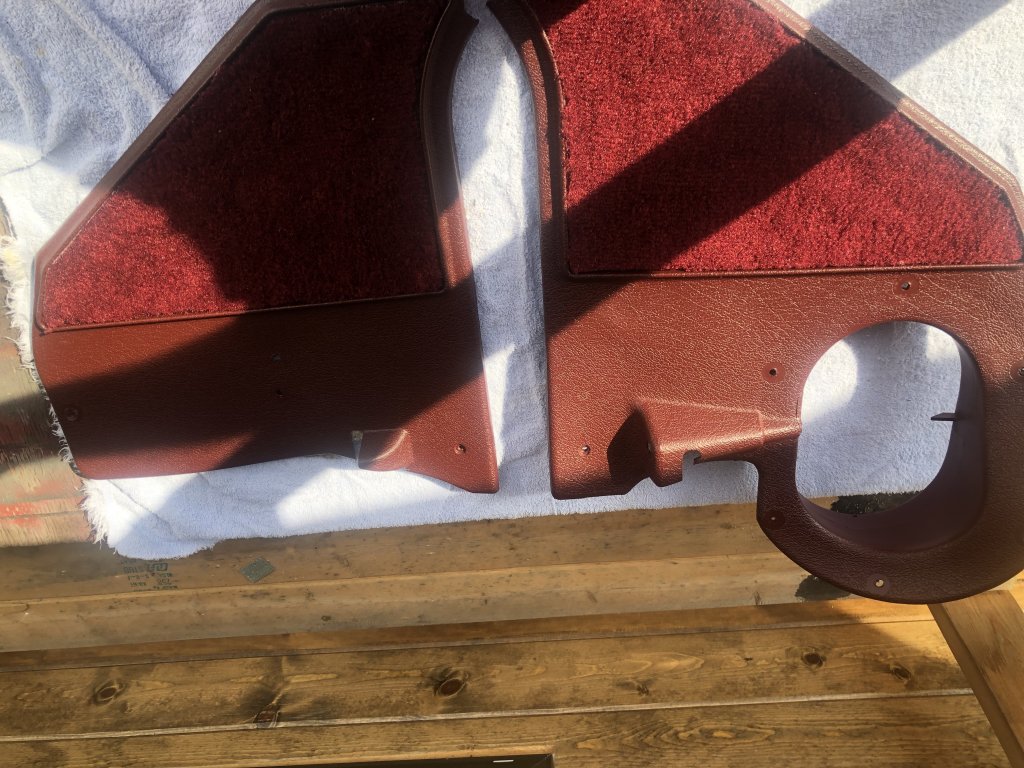

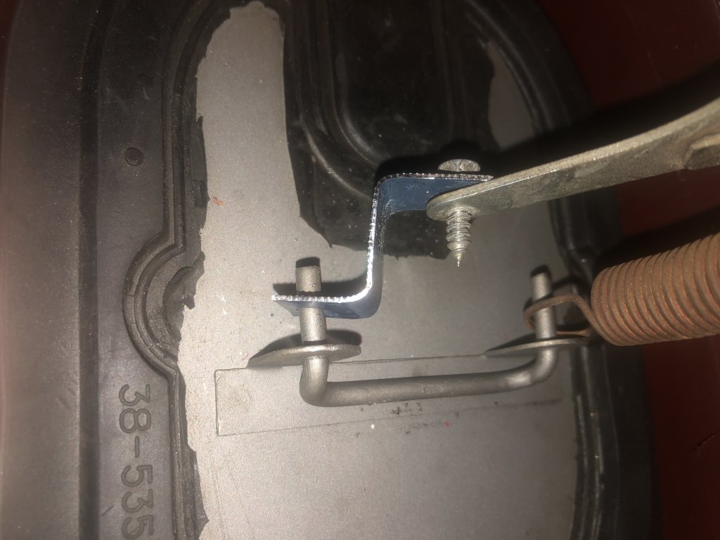

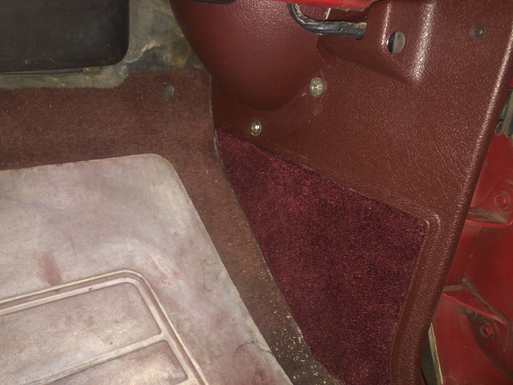

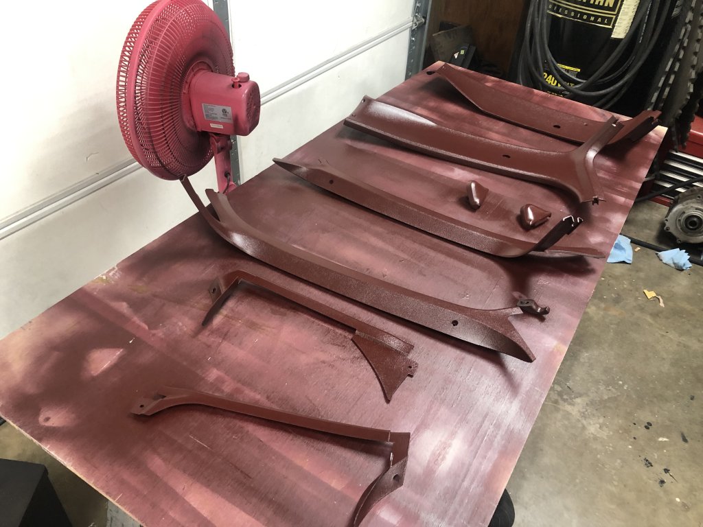

Been slowly redoing my interior as time and money allows. Just a note if you’re replacing the vent door on an ac truck you’re going to have to fab a bracket to make it functional and I used a heater cable retainer to hold mine in place.

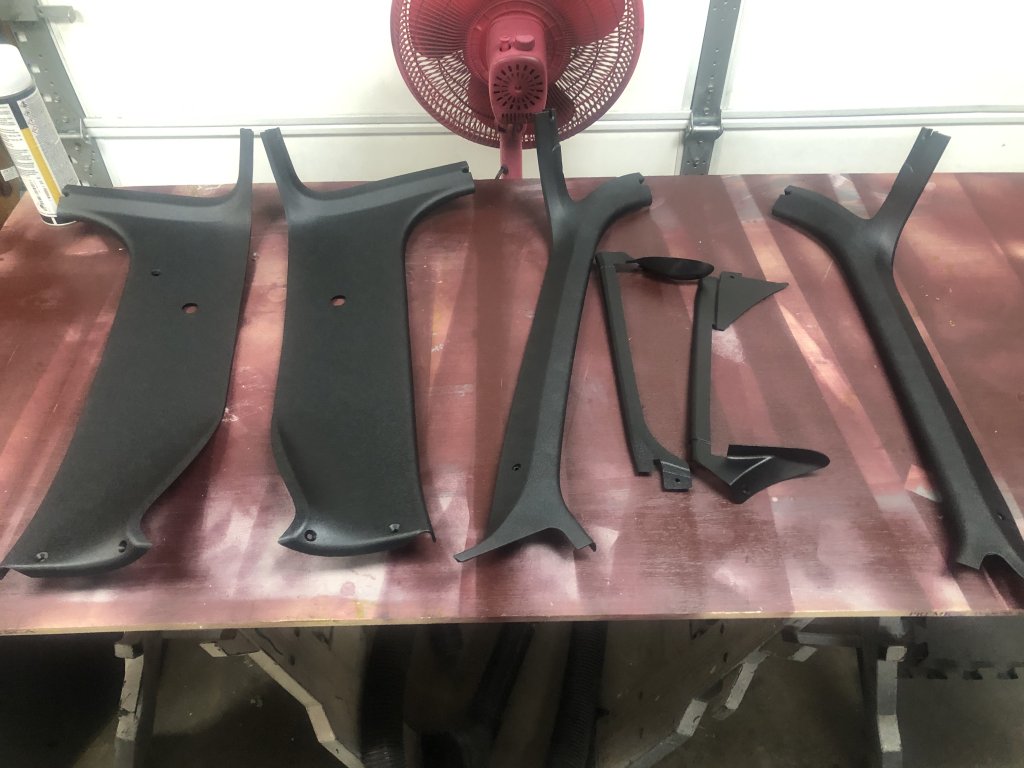

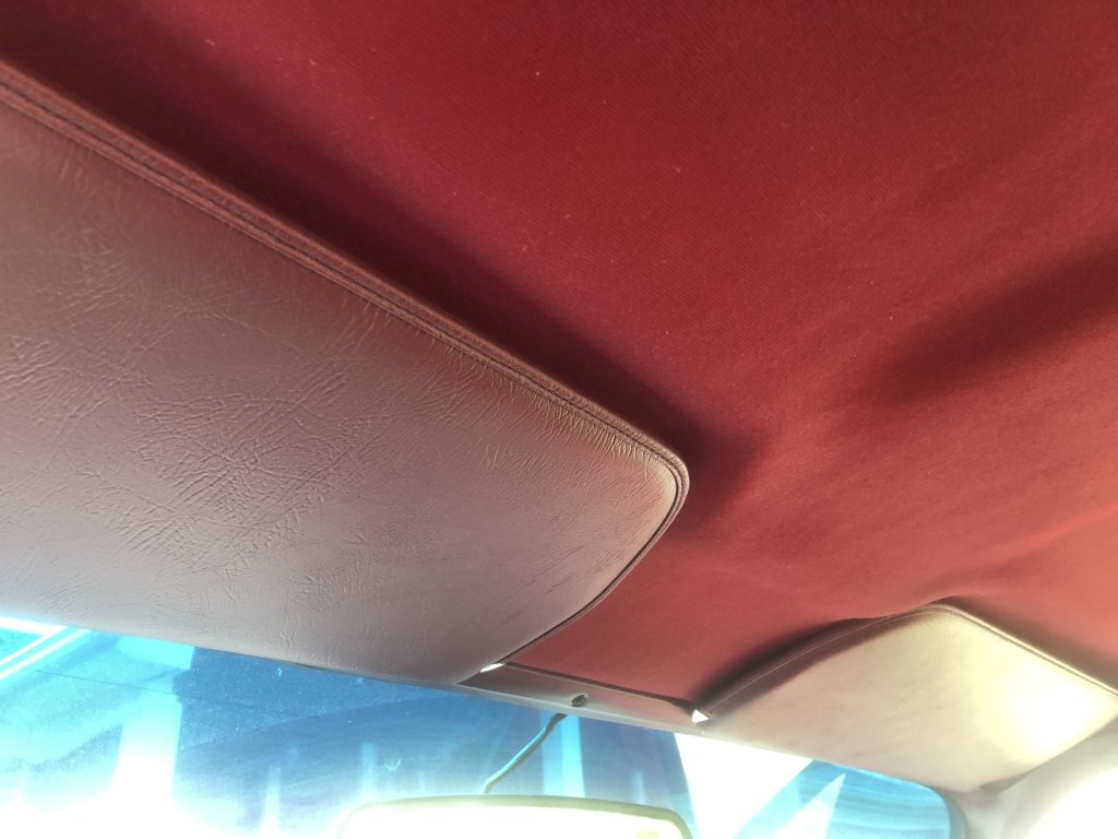

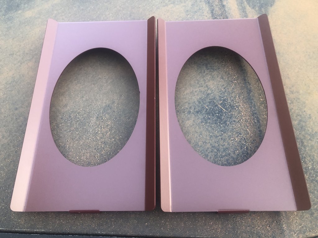

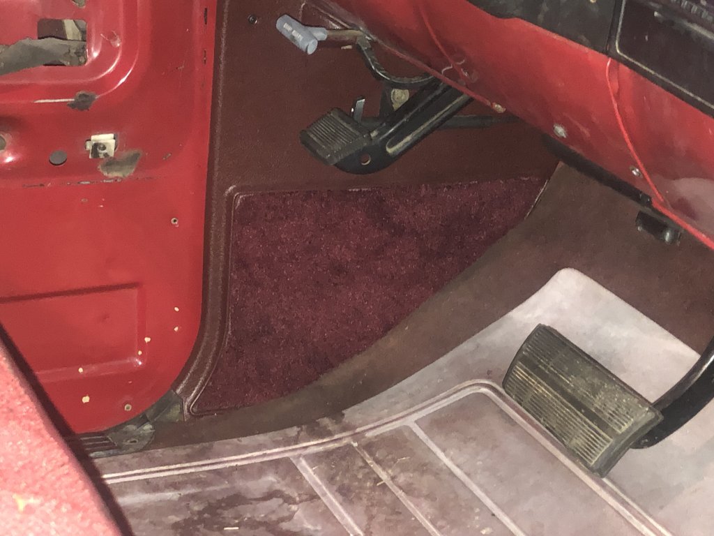

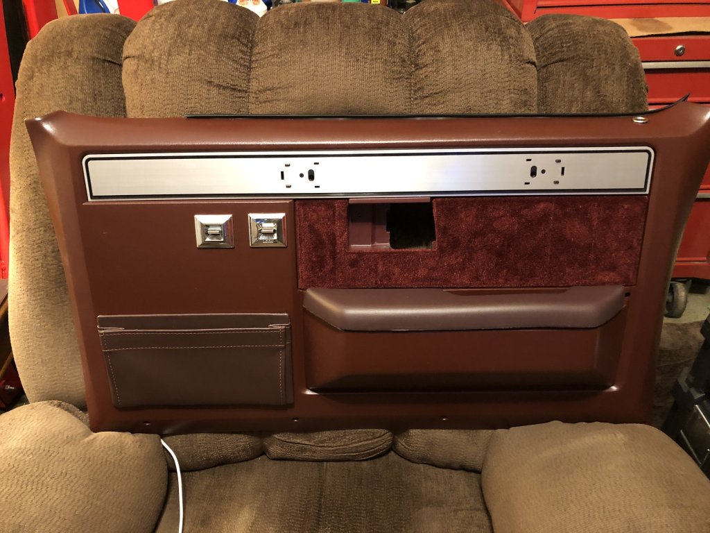

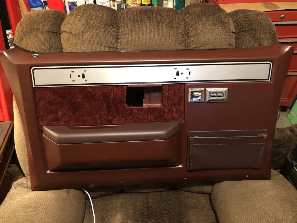

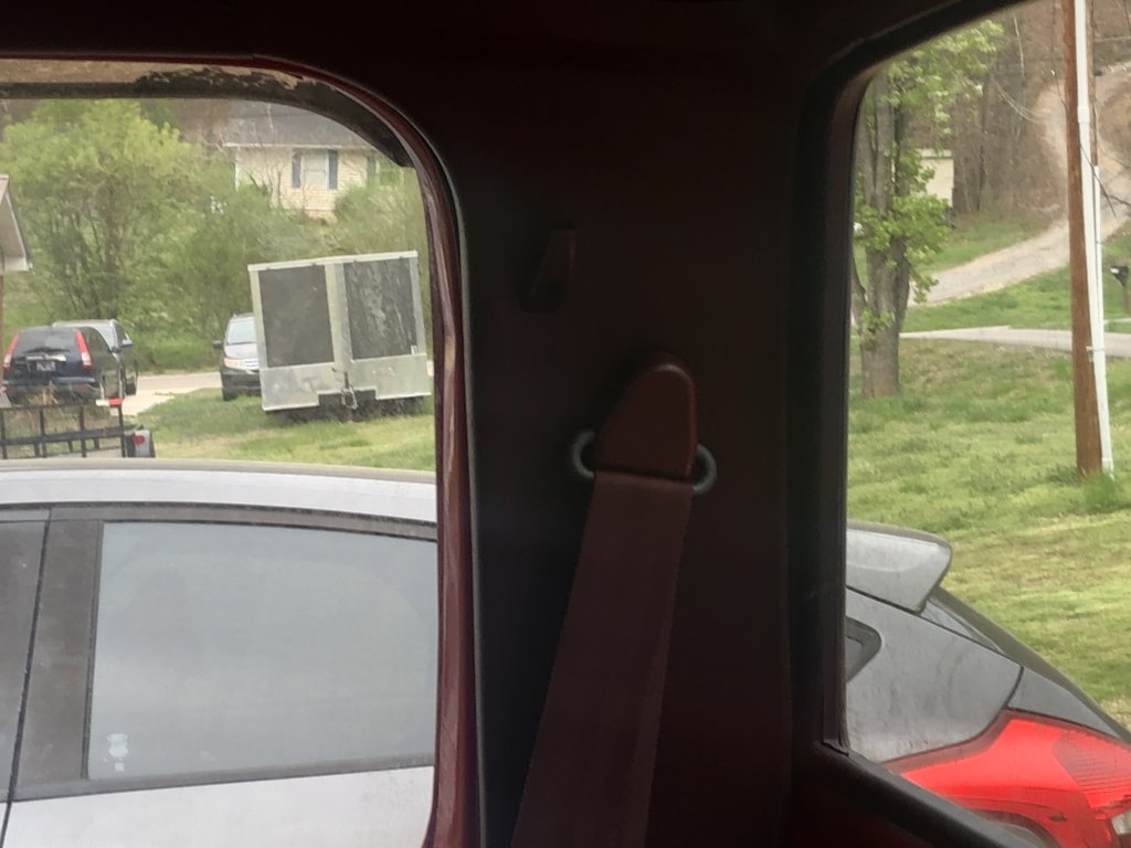

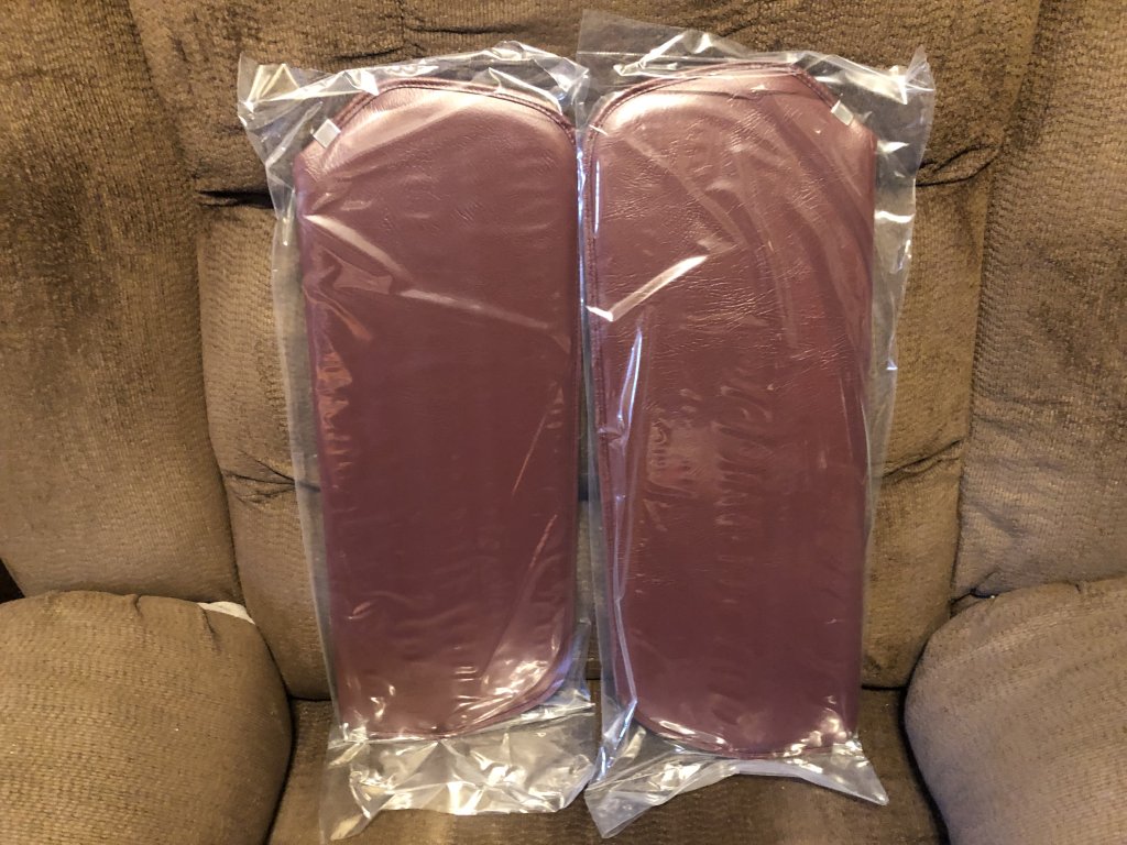

More progress

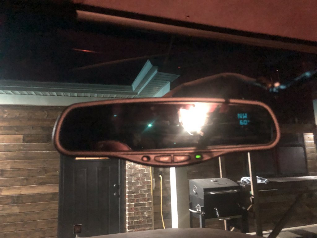

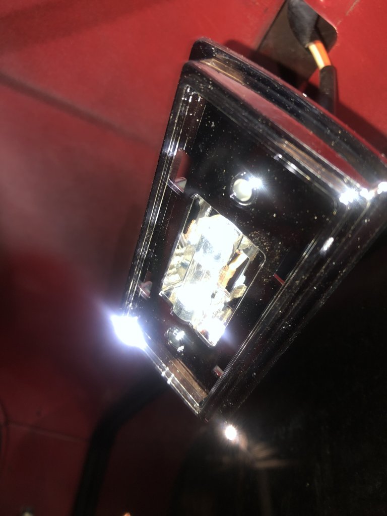

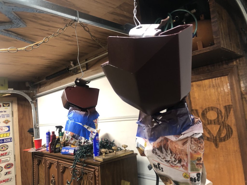

Also added a more modern rear view mirror

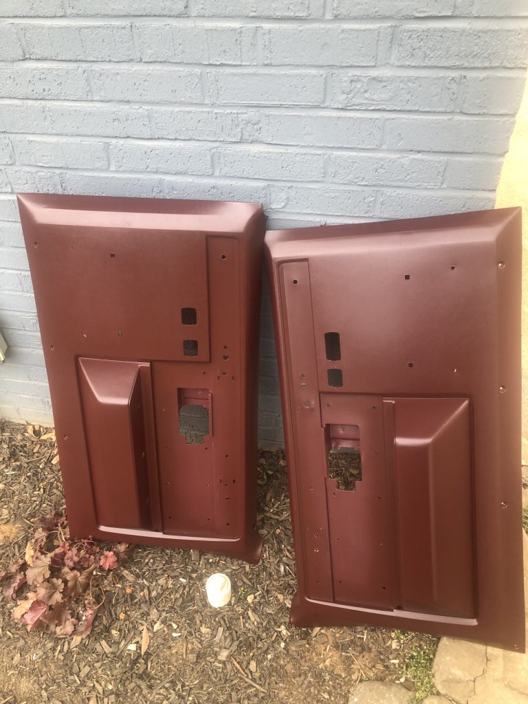

Looking good so far! @Hamgrease Jonathan, what color and brand dye(paint) did you go with for the door cards, seat belt harness cover, etc.?
My interior is red just like this and my door cards are in the most need of recoloring. I have researched a few brands, but this looks like what I hope I would find.

I’m changing Lisa’s truck from burgundy to black with purple soft goods interior. Adhesion promoter and Krylon Fusion Matte Black. A couple different purple velvets, dark door card inserts, lighter headliner, real hardwood trim instead of brushed aluminum over black plastic door strips. Purple guitar pick-esque dash insert instead of the fell off in the heat glued down aluminum.
SEM is probably a “better” choice, but… Happy wife, happy life, her truck.
