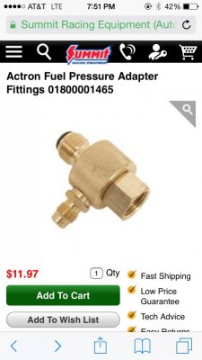

They sell a piece at Summit that is supposed to serve as a Schrader valve right behind the TBI. I think that's how it works.

Fan you hear the fuel pump prime?
I have heard those fittings are hard to get installed in the line running into the TBI. if one of the lines comes loose from the filter you could spin the filter off the other line....

I'll check into that fitting, might be the best easiest option rather than cutting fuel line and putting in compression fittings. Fingers crossed it isn't the pump, money is so tight at the momebt
I've a couple of those, work great.
On the 4.3, it's not possible to install behind the TBI, but the 5.7 fits fine.

I changed out the throttle position sensor and can't get the code 22 to go away which makes me think ECM, so I ordered a remanned on today, but have checked and changed everything but the fuel filter, because I can't get it off, and the last thing is the pump. Which is know was bad if I could get the dang filter off. Tried to find the fitting mentioned earlier but looks like I'm gonna have to order it. Tired if guessing and pissing away cash on parts I've already replaced....lol
