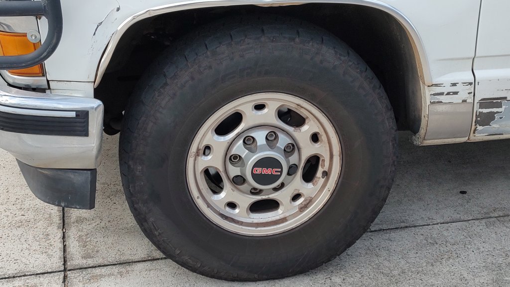

The 8 lug pattern is the same on GM trucks through 2010; after that they went to a wider metric pattern. Ford and Dodge made the change somewhere in that timeframe as well. I know the Hummer H2 factory mags will fit the OBS truck so they'll also fit a square body. Those are 17" diameter and the GMT 800 series PY0s are 16" so they can still work with a stock size range tire.
This picture is the PY0 with the OBS center cap, was on an OBS Crew Cab I saw at work one day. Got a picture of it with my truck, since I don't often see two of the longboys together.....
