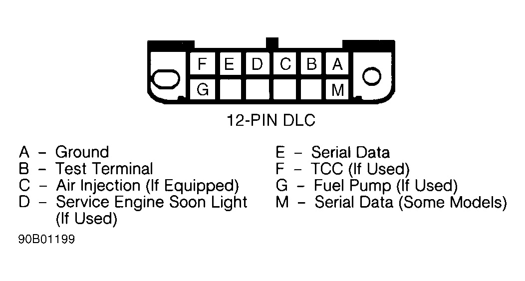

This?

I think that above image is of the OBD1 ALDL pinout. I believe he's wanting the engine bay wiring harness pinout off the firewall.
I'd like the same thing for an 85 Gas and Diesel to convert my OEM 6.2 to Gas. I too have problems following the complete wiring schematics. I'd prefer a pinout description like this ALDL diagram telling which each pin is for but for the bulkhead pinout.
Ahh, I gotcha.
