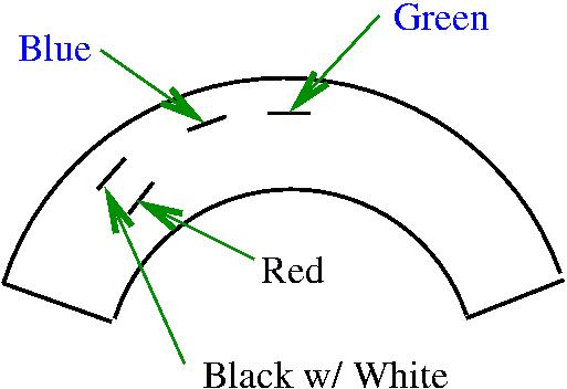

Here is the wiring I see on the pieces of the neutral safety switch that I found in the truck. One plug with a red wired and a black w/white wire. A second plug with a green wire and a blue wire.
See the attached drawing of these connections.

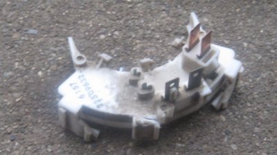

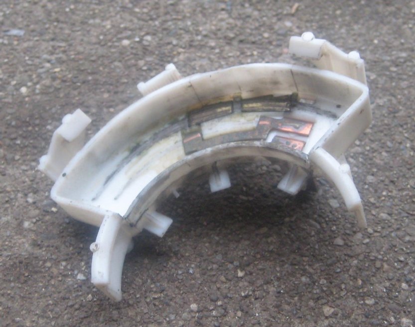

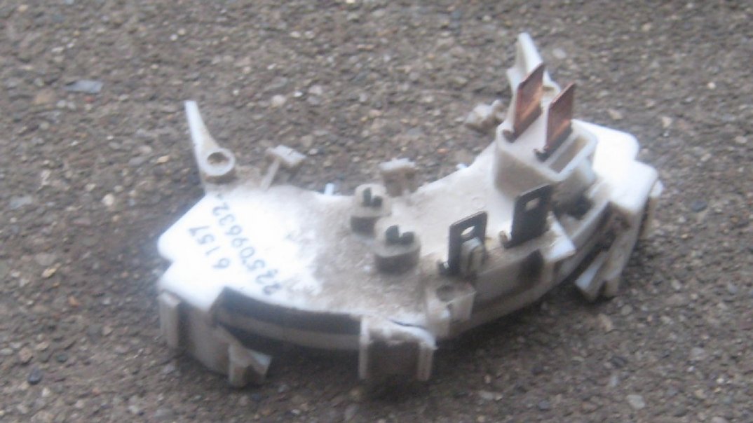

Here are a couple of pictures of the piece of the neutral safety switch that sort of fell out of the truck. It was mounted on the top of the steering column. It was only hanging on by a small piece of the original plastic housing. Obviously there is still the other half of this switch assembly still attached to the column. I have not yet figured out how to remove that other part yet. Do I have to drop the column to change this?

I'd say that's your problem. I'm pretty sure if you jump the red and black w/ white wires, it should start. If not, your reverse lights will be on, and then you'll want to jump the blue and green to start it. Lol! I'm pretty sure it's the stacked connectors on the left anyway. Usually they're both purple, because one of them goes to the S terminal of the starter.
