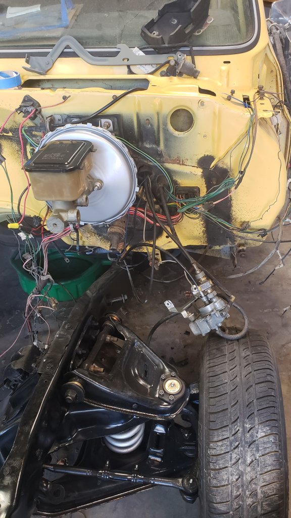

My '82 with factory cruise, looked like this. I removed it since this picture though, since it was incomplete, and a mess of wiring. It's the silver piece with the vacuum lines running to it, sitting on the tire in the picture below. Bolts to the drivers side inner fender, like in the other picture below, from the day I got the truck.
