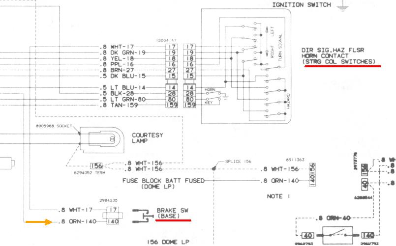

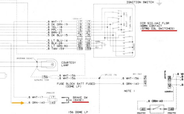

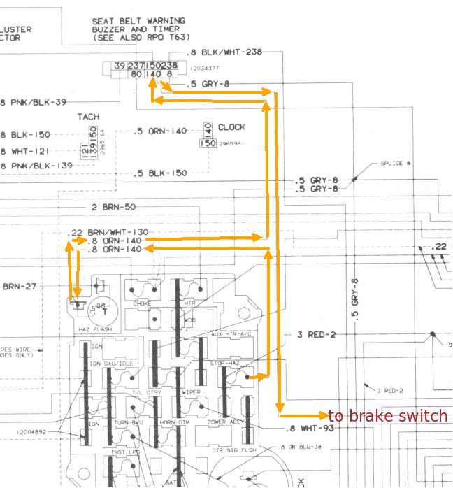

Brake switch is fed by ORN-140 and leaves as WHT-17 that feeds turn signal switch for brake lights. So if you have no power at brake switch see attachment to see where ORN-140 comes from.

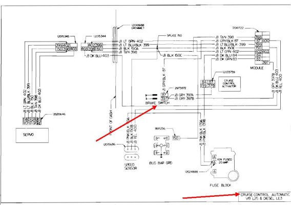

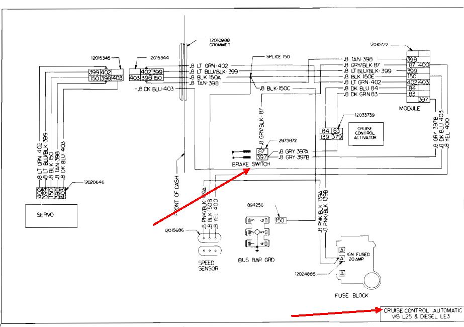

Those are probably cruise control. They are usually connected to same brake switch. Look for a connector with an orange wire & white wire hanging under your dash.
That would definitely explain why everything works except brake lights when braking.
FYI- Brake switch could have two places for connections. One of the connections is opened when brake is pressed and the other will be closed when the brake is pressed.(opposite)
