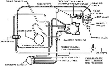

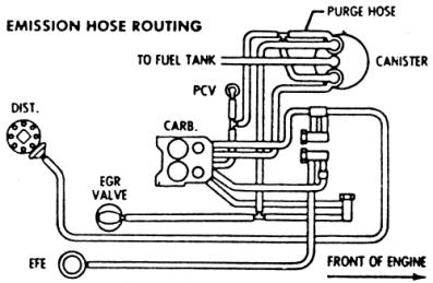

Well i can order them from work here for a good price but the order wont go out till monday anyways so no biggie. i did find these too which should help if my eyes don't go buggy from stairing at all them fuggin hoeses.

Cool. You don't have the original labels or are they it? :popcorn:

The origanal should be under the hood correct? I cant find them so i hooked up with my best friend "google".

Yeah usually on the radiator support or fan shroud.

So wat should i do with any hoes that should go to the air cleaner now that i have this aftermarket cleaner? can i just plug them? Also the valve cover hose? just put a filter on it?
24,922
7,066
The vac hose going to the blend door on the snorkel can be plugged, and yah, the breather hose can be pulled and stick in a filter. I wouldn't remove any more than that looking at those diagrams.
