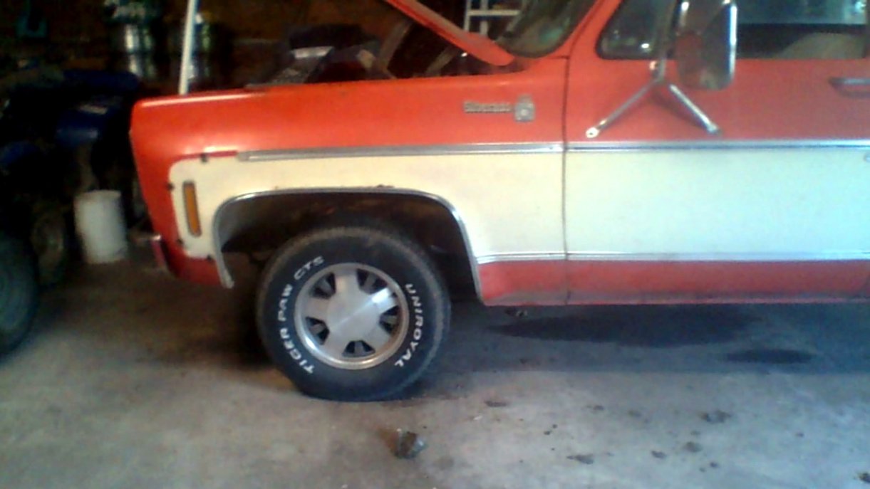

It has the off set hood latch, and i can not find a grill. What other years will work? I have tried a 73 and 78 no luck there. HELP.

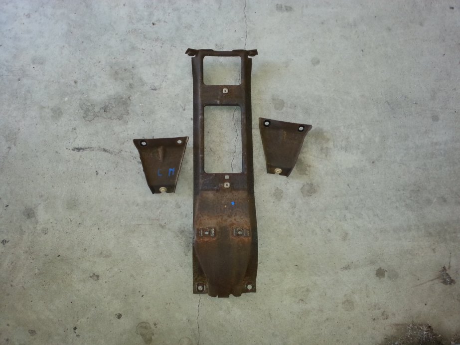

You need to change the center grill support with center hood latch to use a 77-80 grill and you need to do the same to run the 73-74 grill as well as the outer grille brackets. What is pictured bellow is 73-74 only.

73-74
75-77ish?
78 and on
They all have different center braces. In 1977-1978 can't remember which year they also changed from the latch from the hood to the interior.
