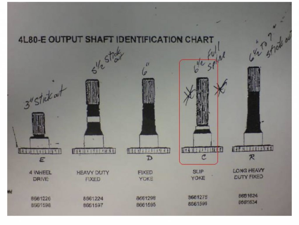

Pretty sure the output shafts are different lengths. I’m not a 4x4/transfer case expert, but I’m almost positive the shafts are different.

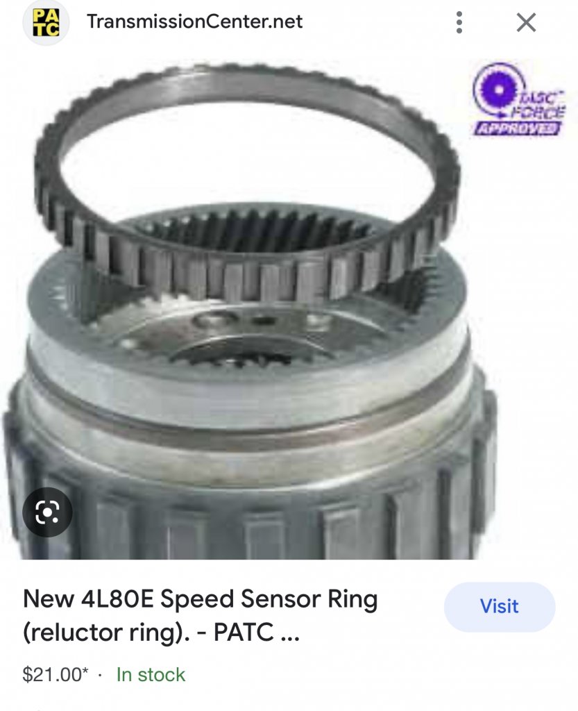

Another headache, and one I’m all too familiar with is the lack of the tone wheel for the rear speed sensor. I assume GM decided not to put the tone wheel on the rear carrier on 4x4s as a cost cutting move. Since the speed sensor in in the transfer case on 4x4s, hole in the trans case is blocked off with a plastic plug and the tone wheel eliminated. No tone wheel, no speed sensor input, lots of drivability issues and codes stored in the computer.
I ran into this very issue on one of my first 4L80 builds. Guy bought a 4x4 core, I bought the output shaft and extension housing to convert to 2wd. The trans was all assembled, painted, ready to go after I put the speed sensors in. It was at that moment I noticed no tone wheel. I had to take it back apart to install the correct parts.

Here is the tone wheel. GM calls it a reluctor wheel.
I have 2 4L80s torn apart right now, both are 2002ish center lube models, one 2wd, the other 4x4. The 4WD does not have the pickup for the rear speed sensor. Maybe GM felt generous on certain day?

Quick google search shows 5 different output shafts. The 4x4 shaft is several inches shorter, meaning even if the spline count is the same, there is no way to put a yoke on it once the extension housing is installed.
