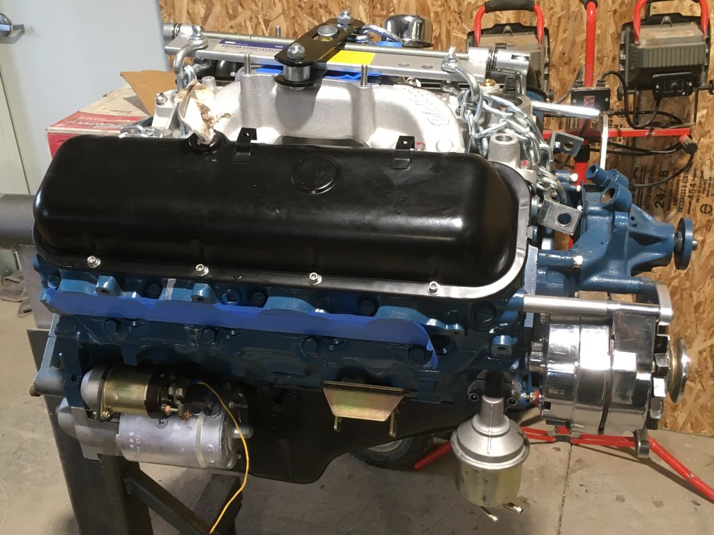

Well, did a round trip yesterday north of home, about 6 hours of country driving, on the way back the old girl failed. Tried limping home, but it had developed a noise that slowly got worse, oil levels & pressure ok, but had to have her flatbed towed home. Worst part was the tow truck driver was a Ford F series man. He couldn't stop ribbing me all the way home. (in good jest, and a good person) Then my mate sees it going down the main street, also a Ford F100 owner. He then text's me, more ribbing! I felt like Charlie Brown "Good grief" Well, did all the checks today and we have chewed out a lifter and cam lobe in approx' 4,500 miles.

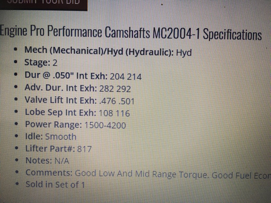

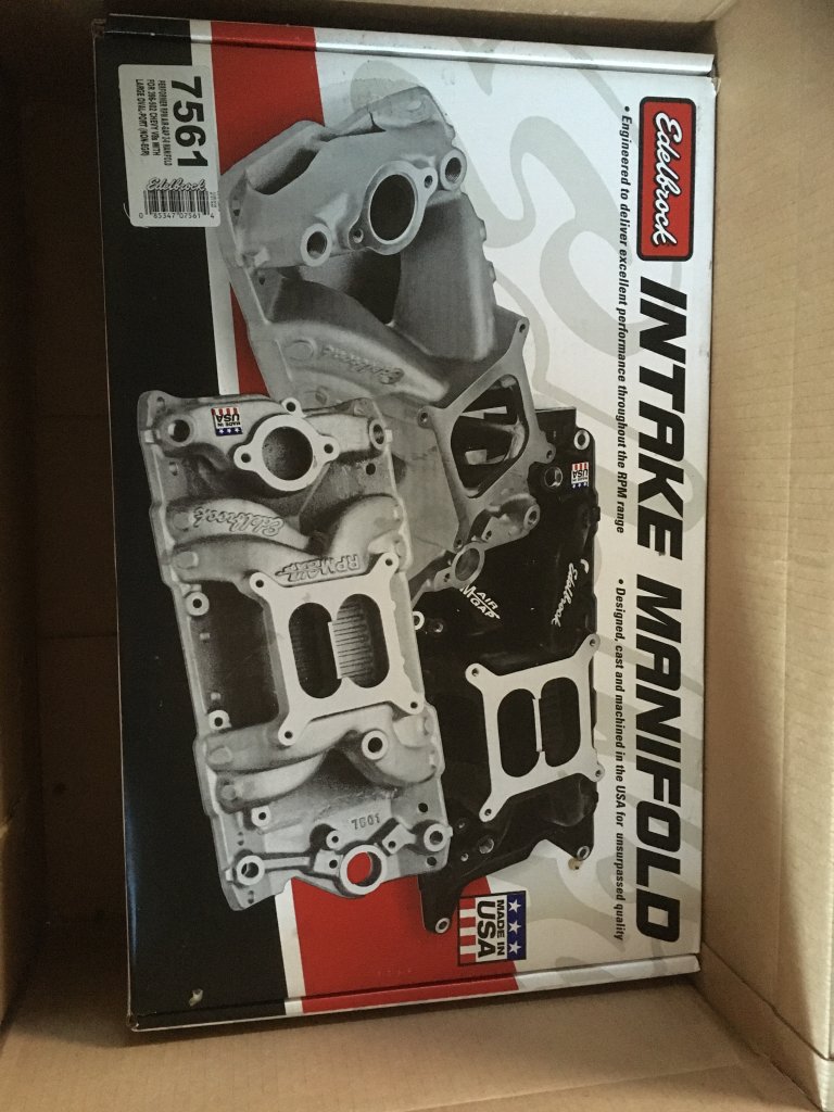

Anyway I'll source a new cam & lfters, any recomendations for a basically standard to mild cam. I am looking at the Comp cams 218/218 High Energy, basic stock 454 with edelbrock perf' & standard exh' manifolds. Current one is an Engine Pro MC1737, not going back there.
