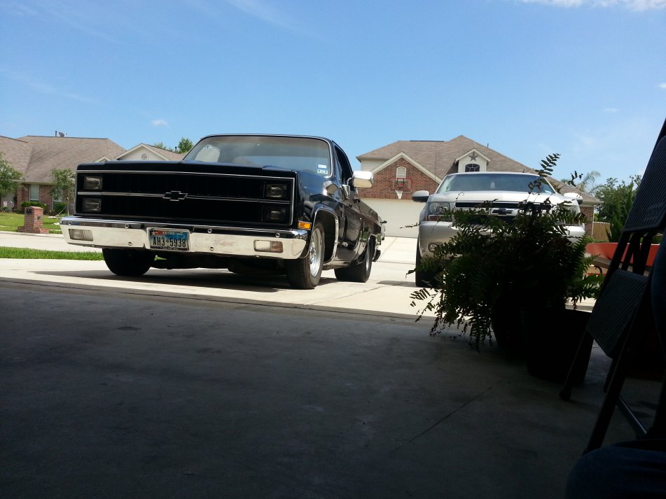

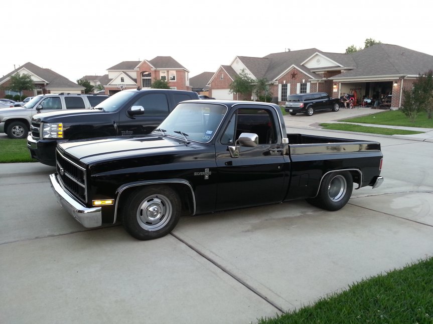

Here is a 295/50/15 on a 10in rim on a 3.5in drop in the rear. I don't have a pic of a 275 but it would be slightly taller and slightly narrower tread.

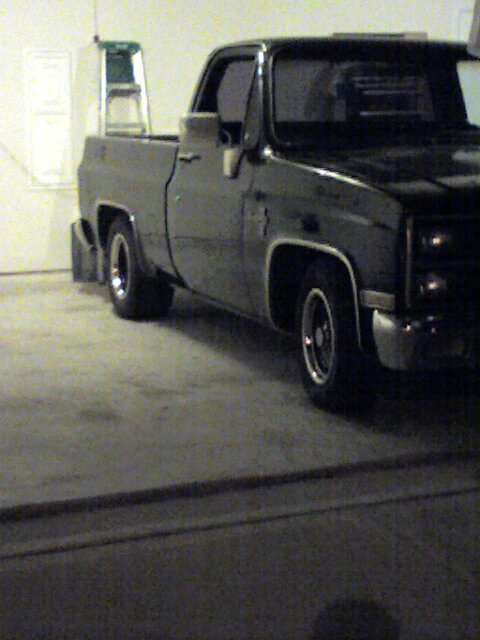

Thanks man, feel free to mirror it if you want to, it doesn't even look like that anymore. Its lower with different wheels.
If I wanted 275s I wouldn't hesitate to put as set on 10in rims. Ive done it before and seen it done countless times.

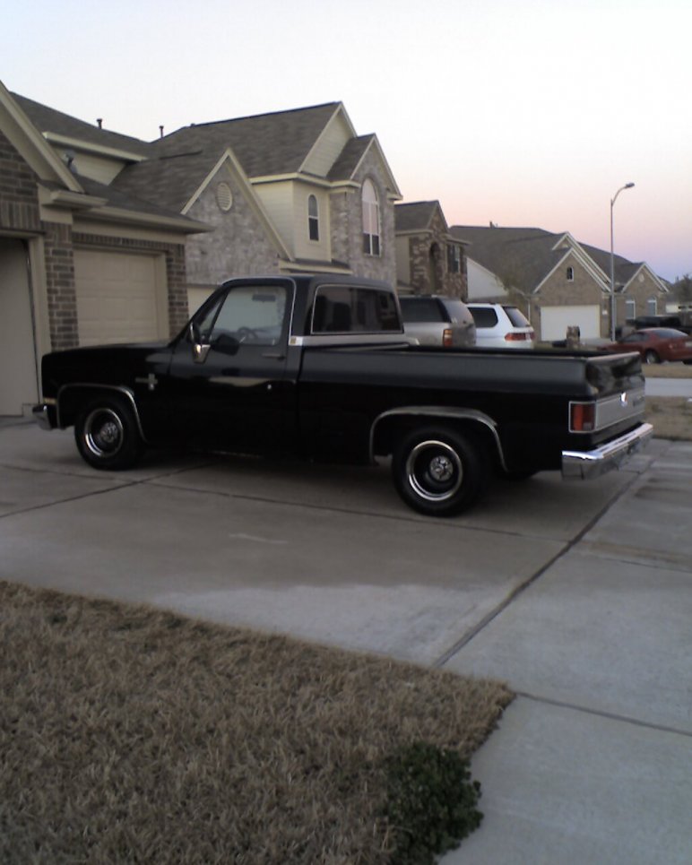

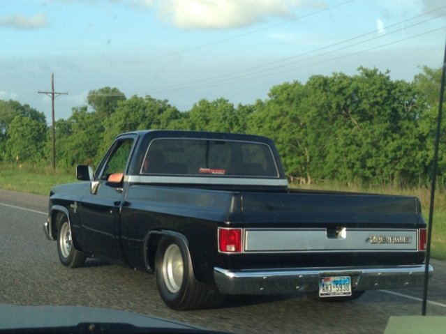

Thanks guys for all the help. I'm thinking 275's for the rear. JKnight what size are your front wheels in that picture? They look super narrow for corvette rallye wheels.
J Knight
Sep 8, 2011
4,298
145
Baytown TX
82 Chevy
350ci
They are 15x6 with 205/75/15 tires which is actually a factory size wheel and tire for a base model square back in the day. I would have gotten a narrower tire if I could find one to handle the weight of the truck.
