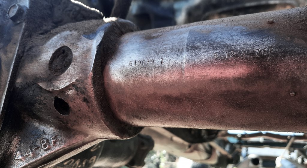

Get in there and clean up around the pumpkins you can Identify exactly what you have so you can get the right parts you need.
Not sure if it's 44 8, or 44 81, 44 B... 8 lug HD with 6 lug spindles...? Got a guess?

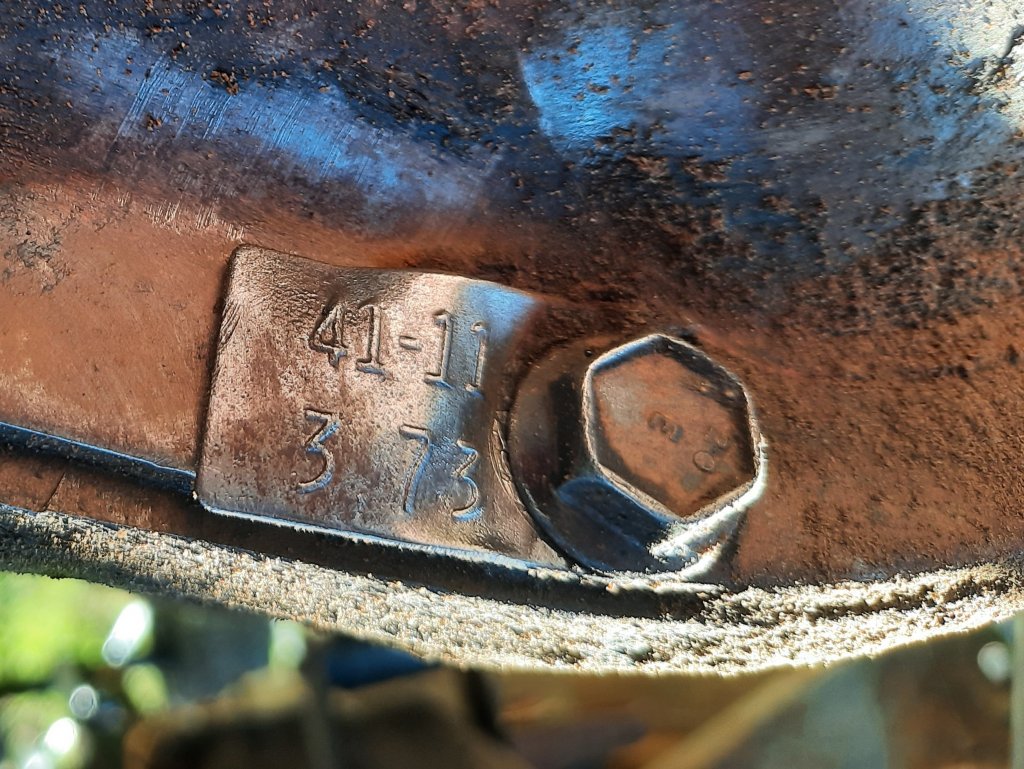

More information... Dana 44-8F (BOM# on the tube) -> 610079-7 3 12 9 7BF And a ratio tag for 3.73 to 1 gearing? I don't know what the 41-11 means either.
I found this on the online AI site:
  • The axle Bill of Materials (BOM) number 610079-7 corresponds to a 1978–1979 GM Dana 44 front axle with a 3.07 gear ratio. It is specifically found in 1/2-ton 4x4 trucks, which includes your 1979 GMC Royal Sierra.
    Axle specifications
    • BOM Number: 610079-7
    • Axle Type:
      Dana 44 front axle
    • Vehicle Application: 1978–1979 GM 1/2-ton 4x4 trucks, including the 1979 GMC Royal Sierra
    • Knuckle Style: Open knuckle
    • Differential: Standard open carrier (for 3.07 ratio)
    • Gear Ratio: 3.07:1
    • Axle Shaft Spline Count: 30-spline inner axle shafts
    • Wheel Bolt Pattern: 6-lug, 5.5-inch pattern
    • Brakes: Standard disc brakes
  • Important notes on decoding
    The full axle tag provides additional details:
    • 3 12 9 7BF: This is a production code. The "3" may indicate a production line or variation. The "12 9 7BF" generally refers to the date of manufacture. It decodes to the 129th day of 1977.
    • Reading the BOM number: The Bill of Materials (BOM) number is a critical code used by Dana to identify the exact parts used in an axle assembly, including the gear ratio, type of differential, and component parts. Traditional BOMs start with a "60" or "61", even if those digits are sometimes dropped on the tag itself. The "610079-7" clearly identifies the axle.
  • Not sure about the 3.07 ratio. Other AI searches said this axle was off a 3/4-ton truck, and that search had the correct 3.73 ratio shown on my ratio tag... It seems that even definitive answers are subject to question.

Good job decoding your axle, I'm impressed you got farther than I did on mine! Like I said Denny's is a good site because they the exploded parts diagram. You can use it for a reference. All the parts are available at many vendors.
I would never call AI searches a "definitive answer".
If you pull that cover, I'll bet you find a 3.73 gearset in there, just like the tag says. But if you do, be sure to put that ratio tag back on there because in my experience, most people don't.
