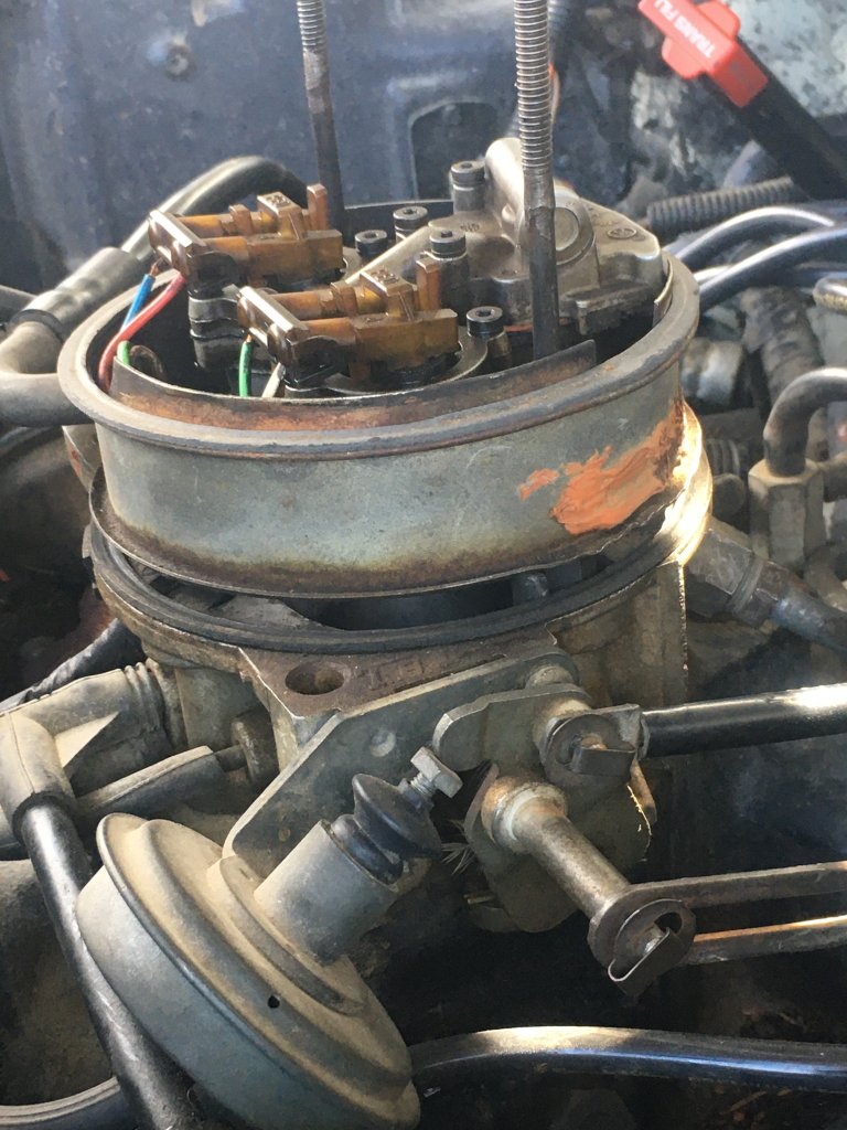

Hey, Thanks for all the help everyone! Are these photos ok?

Yea that's a 454 tbi, at least by the IAC valve and lack of provisions for a TV cable.
So that's good. ^
Do you own a vacuum gauge ?
If so, see what kinda vacuum it's making at idle.
And how about that timing bypass plug ?
