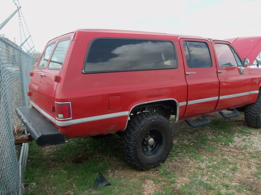

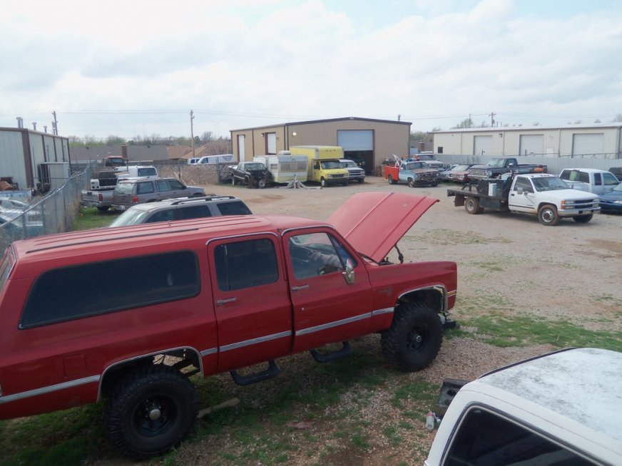

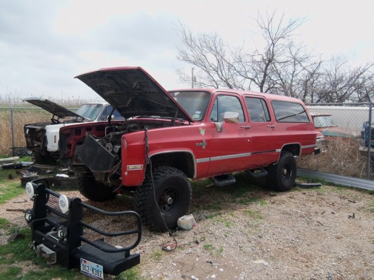

This Burb is what those front lift springs came off of. And everyone seems to think it appears to be 4in lift. It had 2in blocks. I didn't get them since I already some looked to be even taller than them, maybe 2.5 or 3 in. And this Burb sits lower in the rear, so it made sense to me. I do expect the spring to give me close to an inch. and with the blocks I have, it should sit better than this Burb as far as level goes. I'll have a couple more springs in the pack, and maybe .5 in taller block.
Makes me mad, I wish I coulda had that burb frame and the TBI 350 and computer and harnesses. The frame was surface rusty but could have been blasted and POR-15'ed. It was the sheet metal that was ate up.
