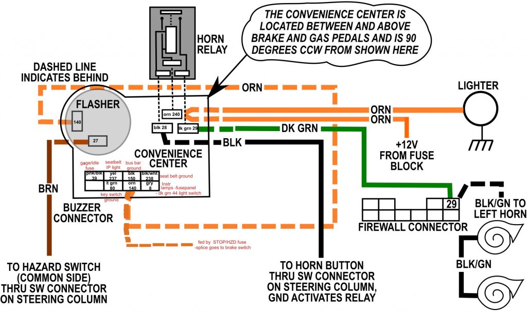

Anyone have a picture of the horn relay can't find it in the fuse box area.

A
Turn on the hazards, listen for the click, that will be your convenience center.

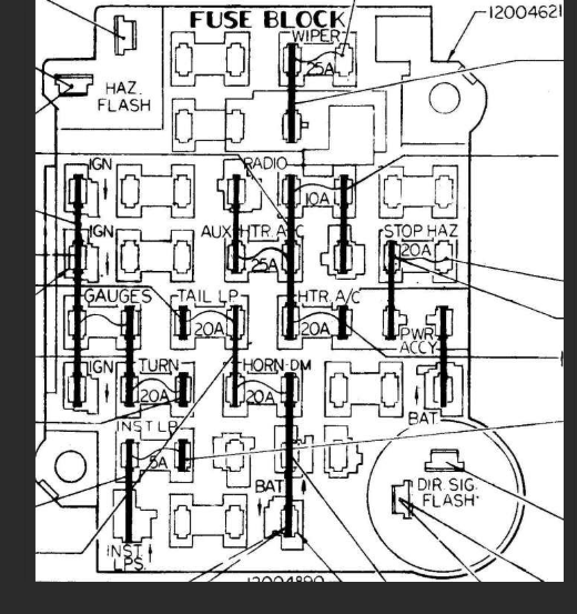

I have a 777 mine looks like this
