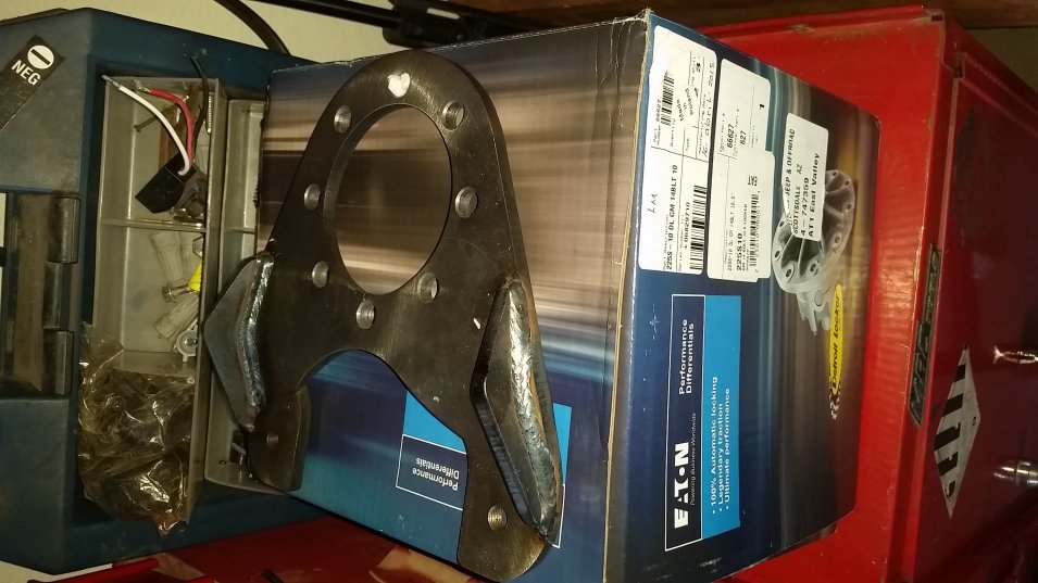

Got it now just need some new gears and a master install kit and shes going in

nice! and rear disks? what calipers are you using I just order the Cadillac calipers ill let you know how they work

I just ordered the fronts off a 3/4 ton. Ill get one of those big black wheel chalks for now till i figure something out ....line lock... pinion brake...if those cadi eldo calipers work id be interested in em
