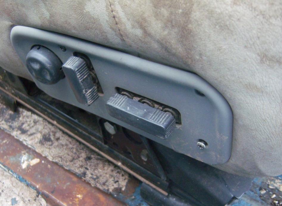

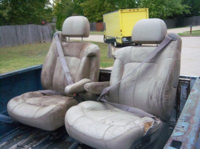

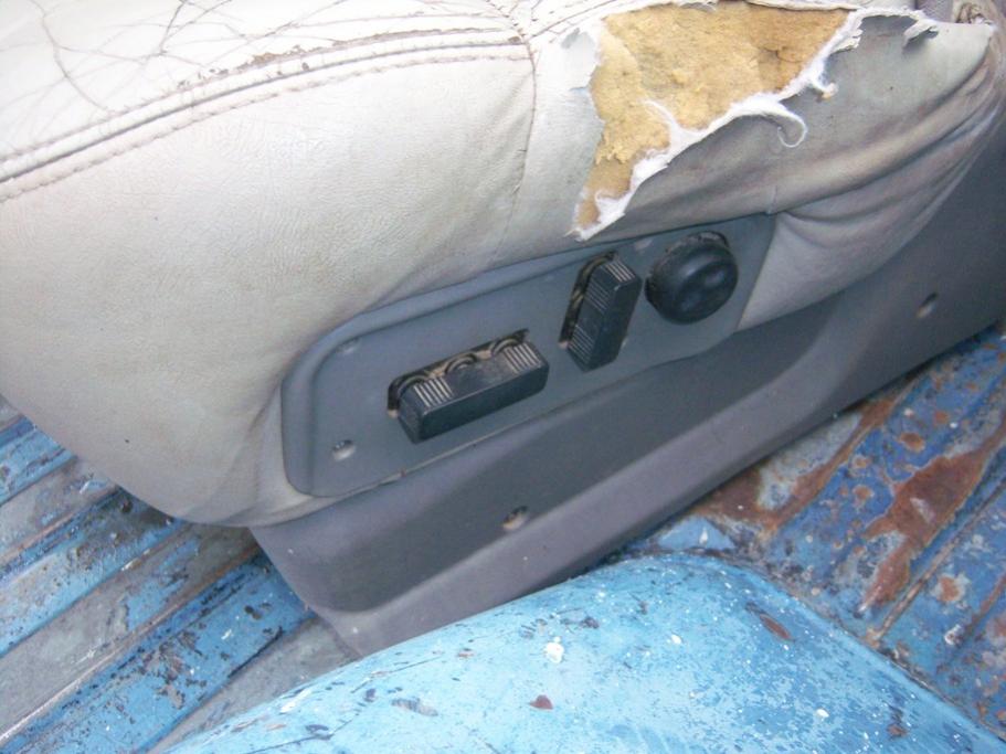

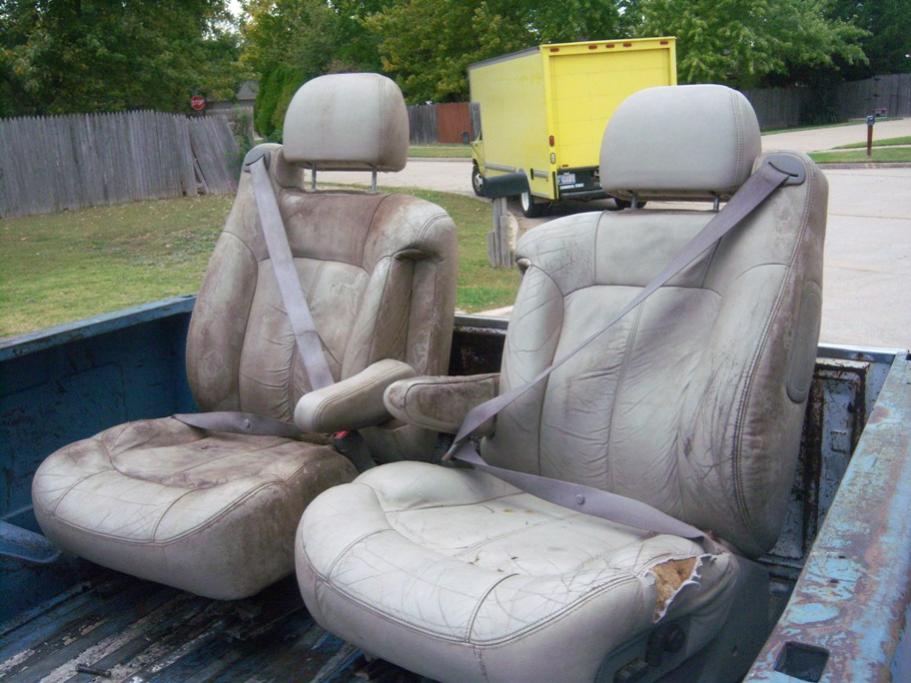

I was driving thru a neighborhood yesterday and this guy was carrying the second one to the curb. I stopped and asked what the deal was with them. He said, I just got a new set from the junk yard about a year ago since my driver seat got tore up from me sliding out of the truck with my tools on my belt. Said it cost him the same to buy new front seats at the junk yard as it was gonna cost him to get the matching leather replaced in both driver and passenger seat. He said they look terrible now that they laid in the backyard for a year, but you can have them if you want to help me load them in your truck. I asked if they worked. He said, no problems, all the power functions worked, the seat heaters worked and all. I think he said it was an 02 Tahoe they came out of. Both driver and passenger have the same features. Seat belts also built into the seats. Side impact air bags too, but doubtful I'll hook that up. Of course I'll have to find someone to reupholster them, and cloth woudl be fine too if the seat heaters won't burn the fabric, otherwise, I'll probably just get new leather off ebay. You can get it off eBay for about $150-$200 and then just take the old covers off and put the new ones on. I prefer not to go leather though. I'll add a ciruiit breaker and hot wire from the fusebox and hopefully get them to fit. All the facotry plugs are still there, so not sure if I'll cut those yet, or just acquire the pigtails and wire them in from there. A project for down the road in one of my SB's. Anyone had any experience or issues with the same type of retrofit???

03+ seats?
Ive seen people over on 67-72 running 95-99/99-02 seats
Shouldnt be to hard to get them bolted in

I sure hope it won't be tough. I have a bad back and can't do long drives, execpet when I was in my 03 Avalanche or 04 LT Crew Cab and these seats. After the big D, can't afford nice trucks like that anymore. So getting these to work in one of my trucks would be over the top fantastic and maybe I can go on a long trip again without eating all that damn candy we call medicaiton. I think I'll tag these seats for my other C20 project since that one I have plans for a smaller motor, overdrive trans and going more for mpg to make a DD out of instead of performance or heavy towing.

It can be done, just a matter of wiring. Only the airbags wouldn't work. Just make sure not to get any wires crossed there or BANG! :Sumo:

About getting these to fit in your truck.....someone mentioned "they shouldn't be too hard to bolt in"......These will not just bolt in and will be a lot of work to get them into your truck. You'd like, I can post up some pics of what it'll take but to summarize you'll have to cut the floor under your seats to take out the humps where the gas tank(s) go and relocate the tank. Once done it's very well worth it but it's definitely not just a "bolt in and your good" kinda thing.
