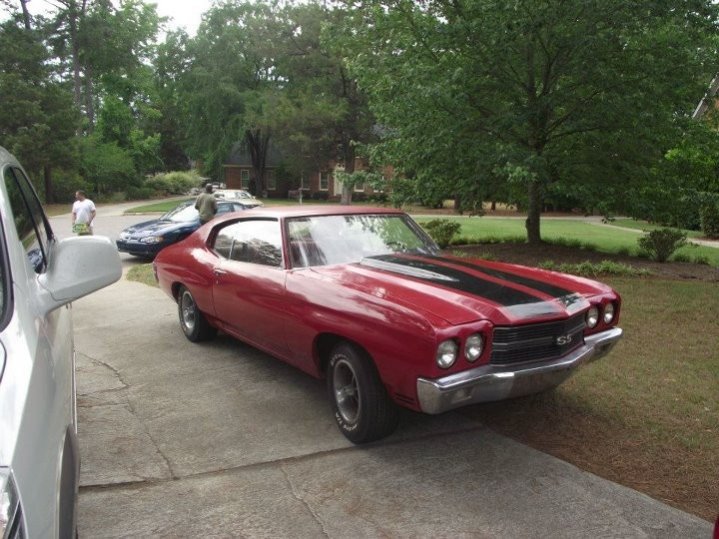

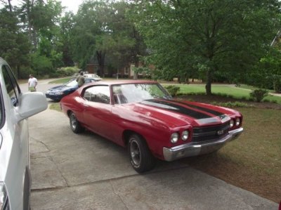

I haven't started on her appearance yet. Just been tightening up a few mechanical things as I have time & when I'm at my mom's where it's stored until I build a new home for it. It runs pretty good now. This is the only decent pic I have right now.

Ooooooooo, purdyyy!
I'm usually not a fan of red, but with the black stripes it looks pretty nice. Like the wheels too, are you planning on keeping them on it?

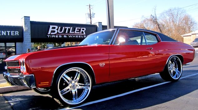

Not sure yet, but my last thought was go with some 20" black Boss 338's. The car originally had a black top on it, but it was never reinstalled after a repaint (I use that term loosely) in the 80's. Haven't decided it if I'll have it reinstalled this time or just have everything smoothed and make it a regular hardtop car. This is a local one that I like on chrome, but it's sitting on 22's and they're too big for my taste. 18's-20's for me.
