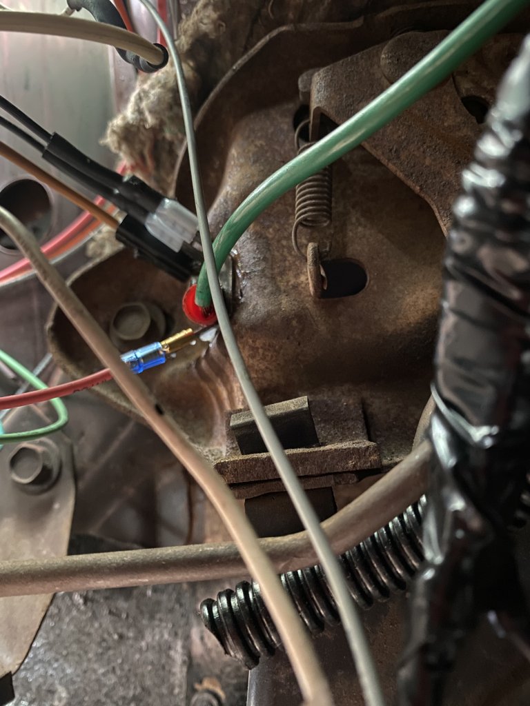

A common place to find this ground and a few others is connected to the top of the parking brake assembly. See photo below. There is a ground block with 6 prongs for various wires to plug into. With the age of these trucks, the mounting hardware of the parking break pedal will corrode and reduce the ability to carry the voltage back to the battery. This is why you see the big green wire that connects directly to the negative side of the battery I am using in place of the pedal hardware to make the ground.
What ground you are talking about? I mean I know what ground your talking about I don't know how it applies to the wipers though. When I talk about the wiper motor ground I'm talking about the ground tab on the motor that is a metal tab which goes from the body of the wiper motor to one of the wiper motor mounting bolts and grounds though the firewall at the wiper bolt. IDK what part of the wiper system is grounded at the one under the dash your talking about. Maybe the delay modules use that spot, but not the wiper motor. Wiper motor is grounded directly to the firewall on the engine side.
