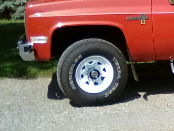

I would not use wheel spacers. I would use the correct size rims for the truck(15"). I think they would have a bit more back spacing. Wheels spaced out too far will kill your paint. These are 10.50 x 31 x 16

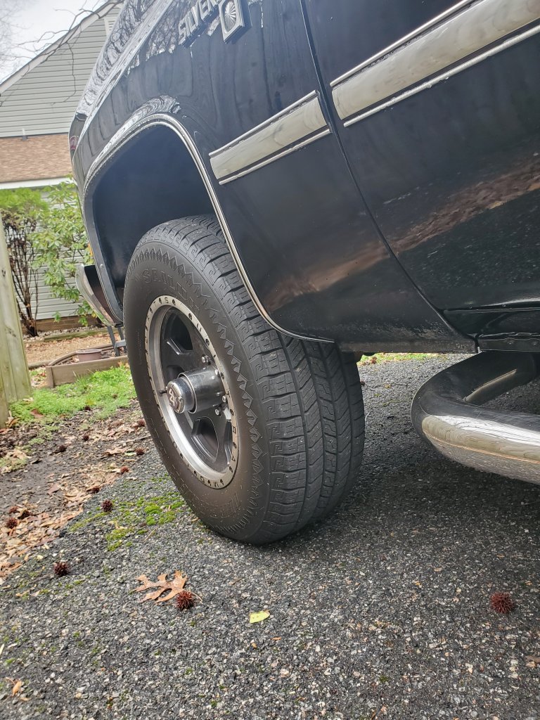

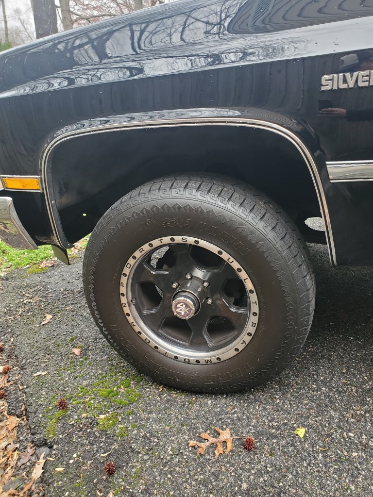

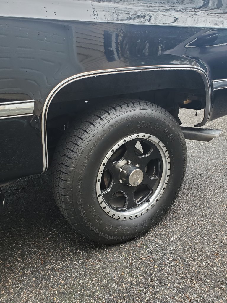

Thanks fellas. I have decided not to use spacers. I'm not going to use spacers. What I currently have on the truck are LT 275/75 R18 tires. The truck is lifted. Not certain but I was told it's factory hight with this V10 model. The front wheels rub a little if you turn all the way in either direction( because the wheels are 18 in now instead of what came with it.) I just was trying to get some info and see if it would be achievable to change it up without breaking the bank. I am happy with the truck as is and stock style is what I would prefer anyway. Maybe I can ask a good tire shop about a different profile. Sending a few up close pics that might help...?

It doesn’t look lifted. If the front springs are flat with more than 2 leafs or smiling it’s lifted. If they’re 2 leaf flat or frowning it’s not lifted.
Also Rim diameter is basically not part of the equation. But yes you could put lower profile tires on those rims. Also the rims look to have a slight positive offset. But you gotta know that if you want to know how to buy better fitting rims and tires.
On the upside they look pretty good IMO on that sharp looking truck!
