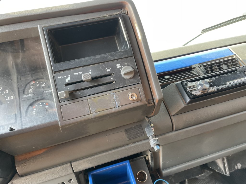

What is this? Accumulator on a non-A/C Truck?
BuiltToWork
Nov 28, 2022
19
30
Stafford, VA
James
K3500
So I have a mystery item in front of my radiator. It looks like an A/C Accumulator, but the truck never had A/C from the Factory (Heat only), doesn't have holes in the firewall like any A/C lines were ever installed and by the way the blue electric lines were run, this did not come from the factory (or someone messed with it).
In addition, one blue wire runs to a relay on the firewall and the other is just free floating with a stripped end.
Pics:
...and yes, I'm cleaning up the wires - ignore the mess.
*edit - Accumulator not condenser

It sure looks like an AC dryer.. wires and pressure switch…. Just put Vintage Air in Easton’s truck at Christmas…

Looks like a previous owner started an A/C installation or removal.
Thanks Randy. A/C Dryer with switch. got it, now to google it to learn more.
Pics:
Can you take a pic of the entire engine bay and maybe one of the passenger side under the dash?
So far in those pics, I can see a filter/dryer, condensor, and AC lines with an expansion valve going through your firewall right next to the heater hoses that are going through in a non-standard position. You have a GMT-400 coolant expansion tank mounted where the blower motor should be mounted on every squarebody, both AC and non-AC. So best guess would be someone installed an aftermarket AC system on your truck... and it all seems to be there from the pics you have posted so far.
Mystery solved (dryer) - but here are some additional pics anyways!

Those pics show you have the AC compressor bracket. I would bet that someone had it going at some point and then had a failure and stripped it back off. You can see the AC expansion valve on the AC lines right where they go through the firewall. I'd maybe start following those lines and see where they go from the firewall. I bet they run across the back of the motor and are either loose or capped off somewhere.
Agreed because behind it is a ac condenser.

The truck has an aftermarket AC system. Looks like it's all there besides the compressor and manifold line.
