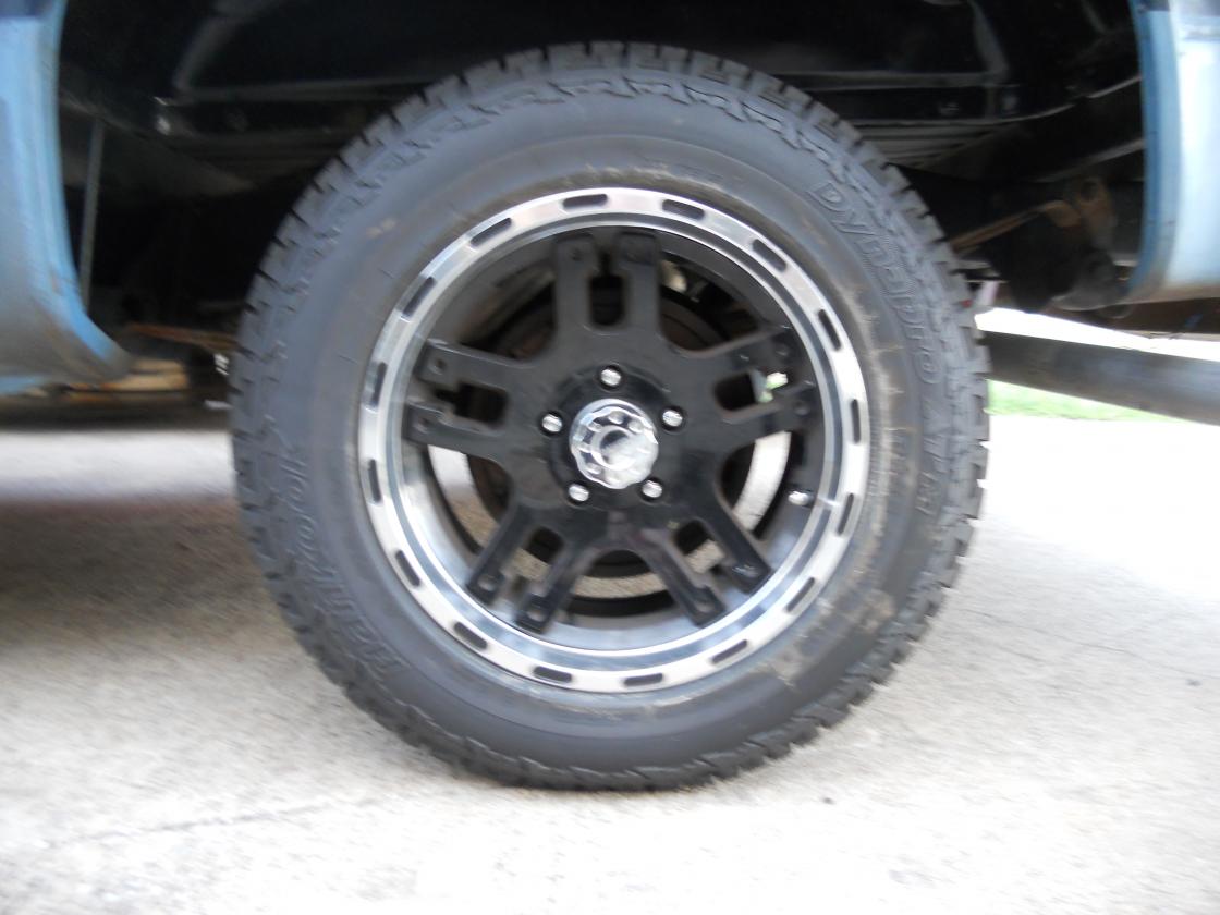

I have been pondering these Cragar Black D windows lately, limit the chrome to a nice new set of lug nuts, and center caps, and if thats not enough, I think I could find some beauty rings to snap on like this guy did.
Guardian
May 22, 2012
254
18
Jeff
86
c 10
My wheels are black and looks like a beauty ring but it is the way they are made.
