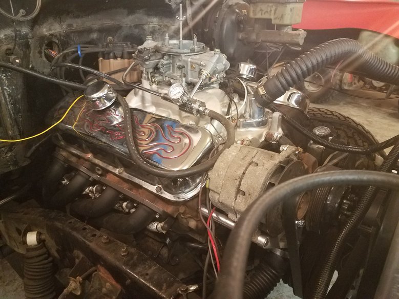

So I ended up doing this swap a few years ago and figured some of you might actually want to know how easy this is. Don't get me wrong, TBI is great for your bone stock 305, but for any kind of modified SBC or BBC swap. Don't bother. It truly is junk and you should be ashamed.
First start with tracing all wires attached to your tbi setup back to your cab. then cut each one and cap them off either with electric tape of wire nut. Later you can pull them through the cab and remove them properly, but for now we are just getting them out of the way.
This next part will range widely on what your engine plans are. I ended up dropping in a 454 with mild cam, aluminum intake, a set of cheap long tube headers, and most importantly a new Holley carb. (Don't buy that Edelbrock junk.) BUT if you are just removing your tbi and retaining your current engine; you will just need a carb, intake, possibly a 1-wire alternator, and distributor. I recommend HEI just because they are better and easier to wire. Feel free to argue with me on that. The 1-wire alternator is completely up to you. To me a 3-wire is just as simple.
So after you have your new engine in place or reworked stocker, you can go ahead and finish tbi wire removal. The wires just pull through that rubbery block by the brake booster and back into the cab. Then cut them at their source.

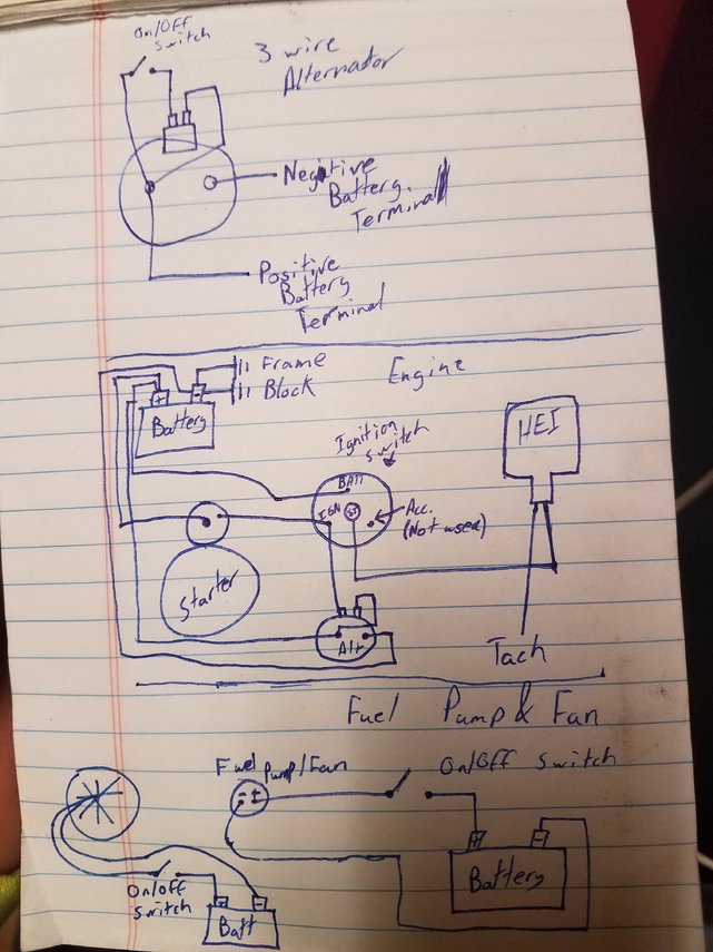

Now you can go to town on your new harness. I used 10 gauge from the hardware store. Buy the stranded wire, NOT SOLID. Just to be safe buy around 40 feet. Better to have leftover that a second trip to the hardware store.
So obviously you will need a basic idea of what a basic engine wiring harness needs to consist of to just the run the engine. See picture attached below. (You may need to download the image to make it bigger.)
So this is what my setup actually ended up being. I ended up running 3 separate harnesses. Don't panic, it's not hard; besides you may only need 1.
The top diagram shows your basic 3 wire alternator on a toggle switch. You can disregard that drawing if you are going to tie it into an ignition switch like the second picture shows.
The second picture shows my whole engine wiring harness. I'm using an HEI distributor; if you aren't just add a coil in there. Everything is tied into a standard hardware store ignition switch. I'm running a switch panel, otherwise I would retain my stock ignition switch. More in depth later.
The diagram to the left on the bottom is for an electric fan controlled via toggle switch and the right being an electric fuel pump also controlled via toggle switch. If you are running your stock parasitic fan, disregard the fan harness. If you are using a mechanical fuel pump or your stock in-tank fuel pump, disregard the fuel pump harness.

Back to the engine harness. All you have to do is copy the diagram. Feel free to add inline fuses if it makes you feel safer.

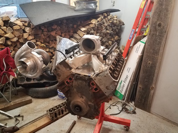

Also through in a picture of my 454 and new engine... LS 5.3 with 76mm turbo. http://www.gmsquarebody.com/forum/images/smilies/party36.gif

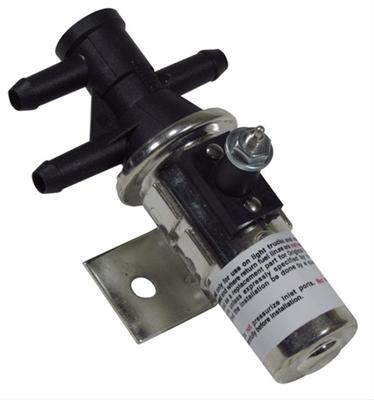

I got my shipment of parts from Summit and I went and bought what I hope is all the incidentals I will need locally. So the TBI to carb swap is underway. I have everything taken apart and the intake is still sitting in the truck with the fuel lines attached being the last thing.
I was thinking before pulling the lines off and lifting the intake out....now would be a good time to figure out a way to completely eliminate the computer from the truck. SO here is my NEW question. I looked through forums in the modification section but didn't find exactly what I am after.
I know that many keep the pumps in tank and use the regulator which I was intending on doing. Splicing the purple wire in the four wire plug to dist and connecting to tach port on new HEI so computer will see signal for fuel pump.
However.....is there a way to just splice into the wire at the dash switch or to the wire going to pumps with a switched hot wire to supply power with key on and then be able to eliminate the computer wiring altogether so the check engine/SES light will not be lit from all the sensors being unplugged?
From what I understand the computer on an 87 only controls the engine management of the TBI system and fuel and none of the gauges.
I will keep the wiring for the computer in the truck but hide it should someone down the road choose to put it all back. If this project doesn't prove to be beneficial I will cut bait as it is said and sell it. And I will offer all the TBI parts I am taking off it now to the new owner in the event they want to chase the electrical goblins.
My wife and I love the truck but she said if it isn't dependable it goes and I can't agree more. It quit on her after all the money spent on the TBI.
Any ideas on the best way to go about the fuel system would be great.
I was thinking eventually to replace BOTH in tank pump/senders with non pump senders. THen run this 3 way valve,
Wire the dash switch to switch the gauge/sending and the tank switch. Eliminate the return line altogether or keep and let it go to one side off the regulator. But I would go with a low pressure fuel pump just in front of the switch valve so it can be used for both. I had thought of two electric pumps much like the current set up but with less pressure then eliminate the new pressure valve.
My question is shouldn't I be able to wire the fuel system this way and where would the best source of switched power be. ALso intend on adding the inline safety shut off in case of low oil or accidents.
