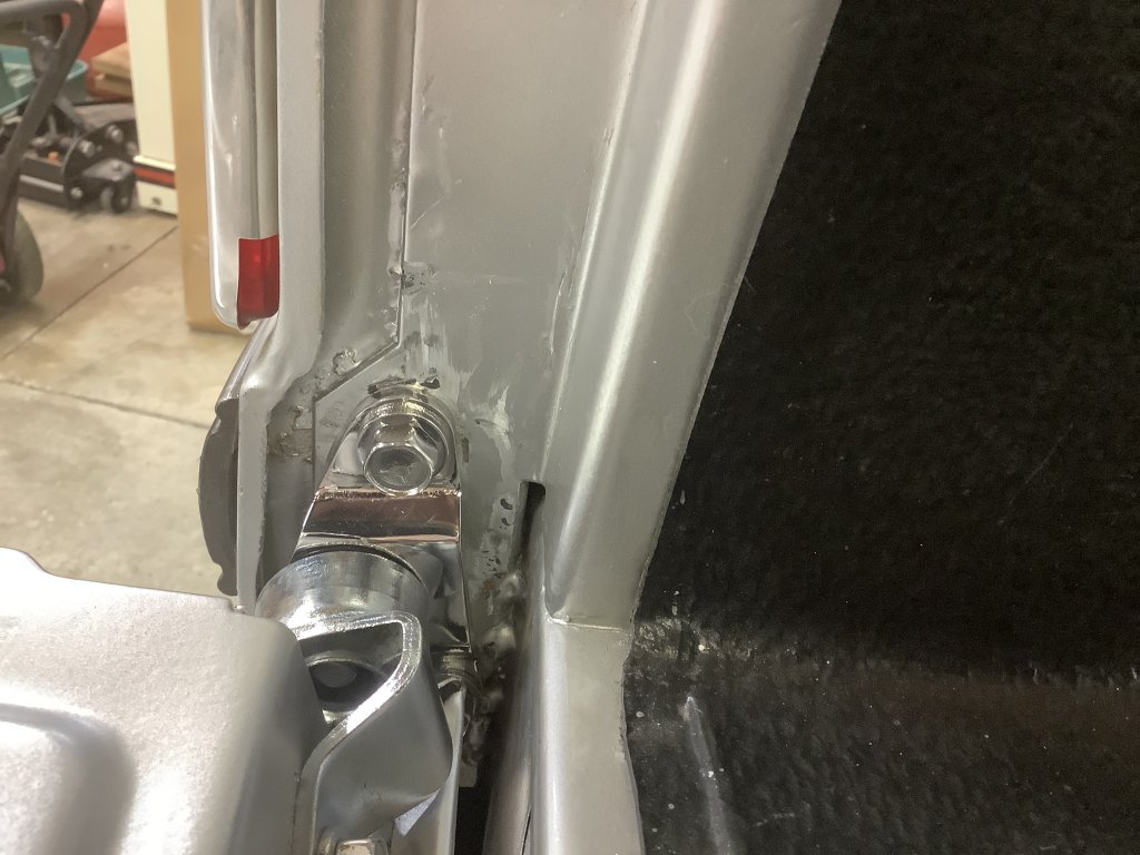

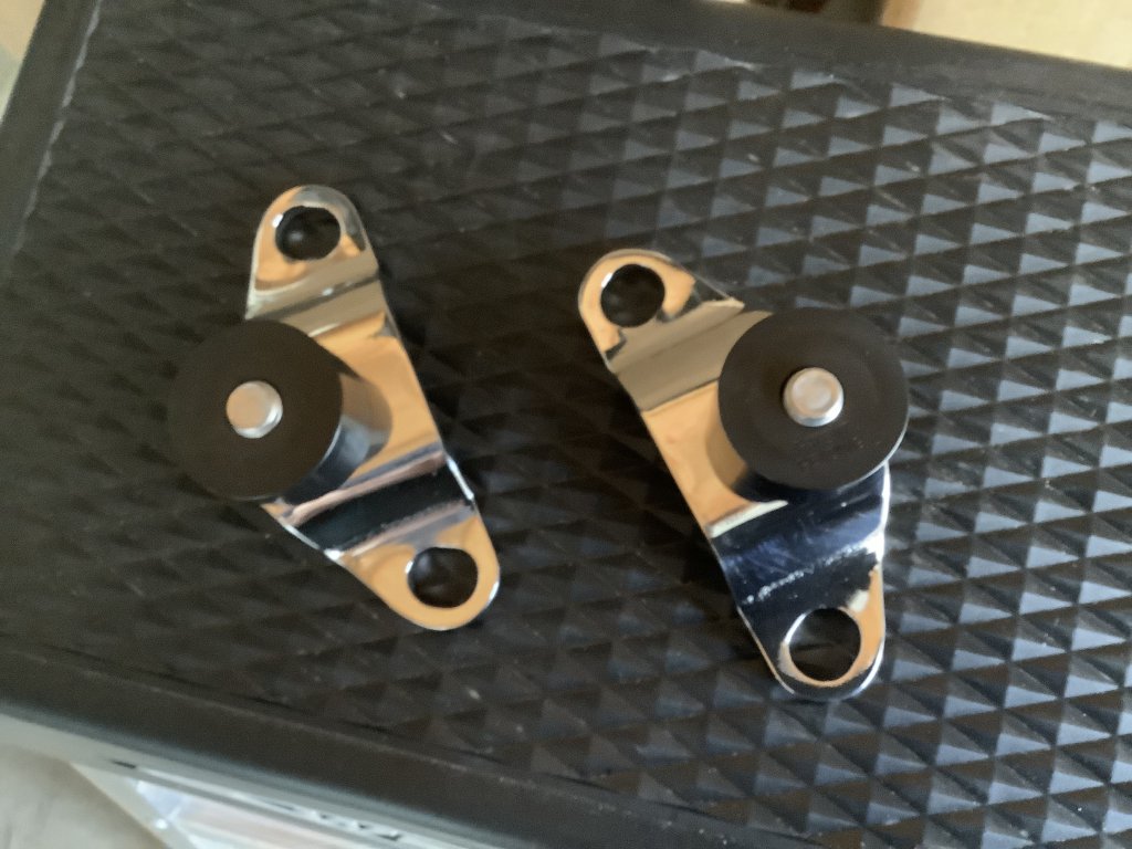

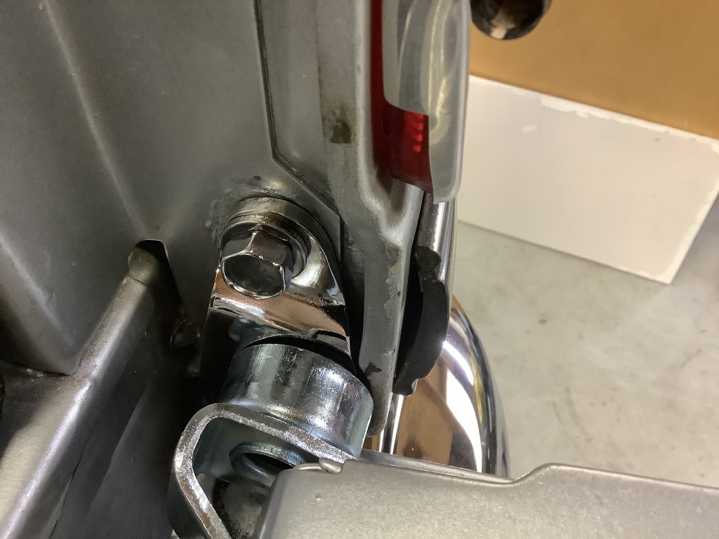

Here’s a great upgrade.. much much better!
FireTruck1984 said:
OK, an Update on the new Stainless Steel and composite tailgate hinges
Worth every penny!! Yes they’re pricey about $65. Very tight fit between the two parts (hinge & trunnion). A little tricky to install because I used 2 Left side pairs, which makes the tailgate Non Removable..
I removed the Left side support arm (elbow) slid the right side hinge on to the right trunnion.. then put the loose Left side trunnion in the Left hinge (cup)…
Now I slid the left side of the tailgate down the side of the bed until the bolt hole aligned. (Note: I figured a way to do this alone, but it’s a Two man job !)
The tailgate fits tight, Doesn’t shake, jump or rattle at all, perfectly quiet. Yes!View attachment 199088View attachment 199089View attachment 199090
