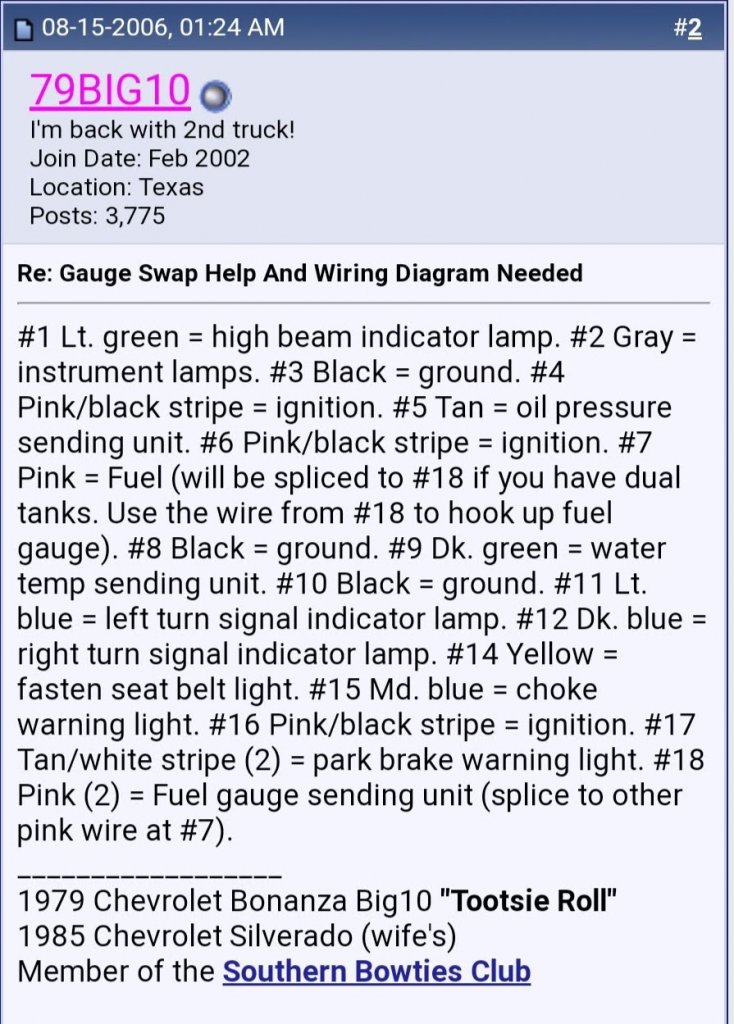

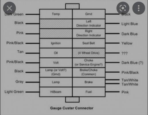

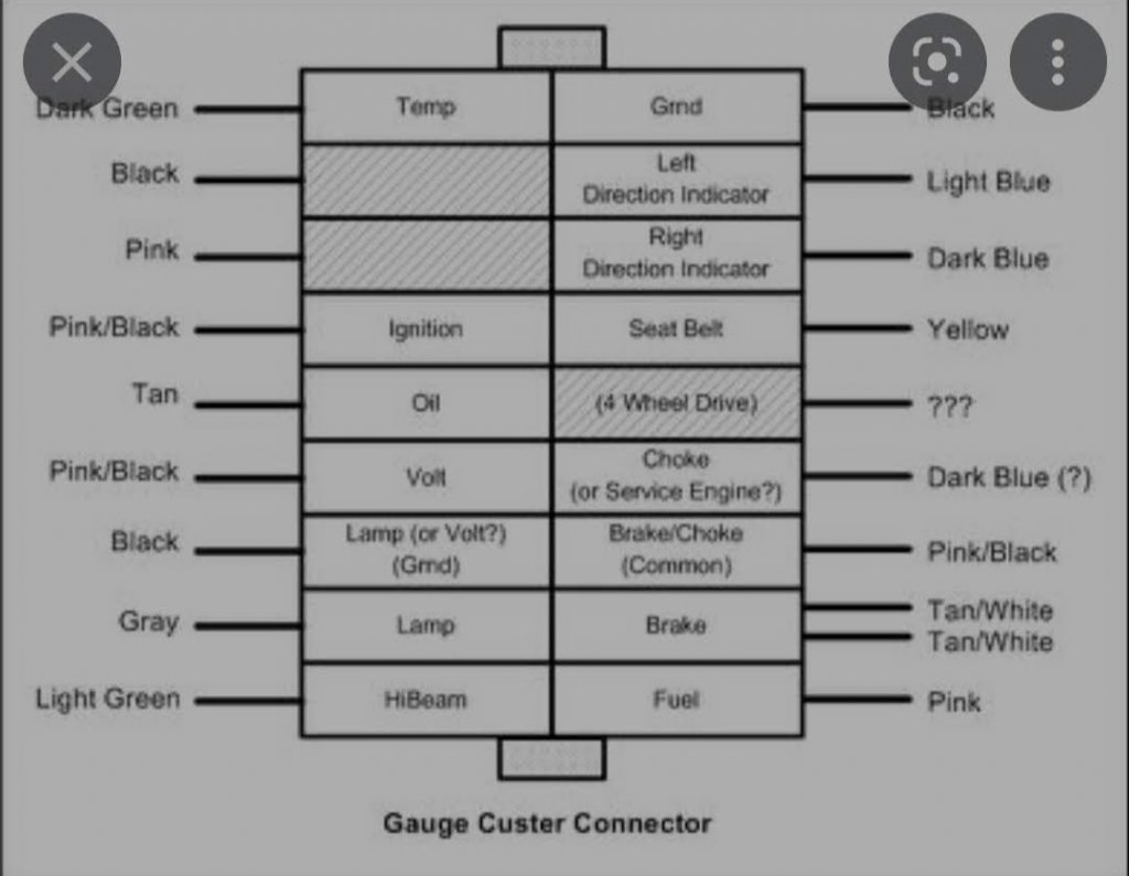

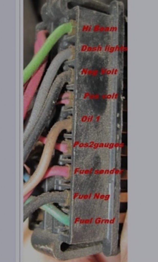

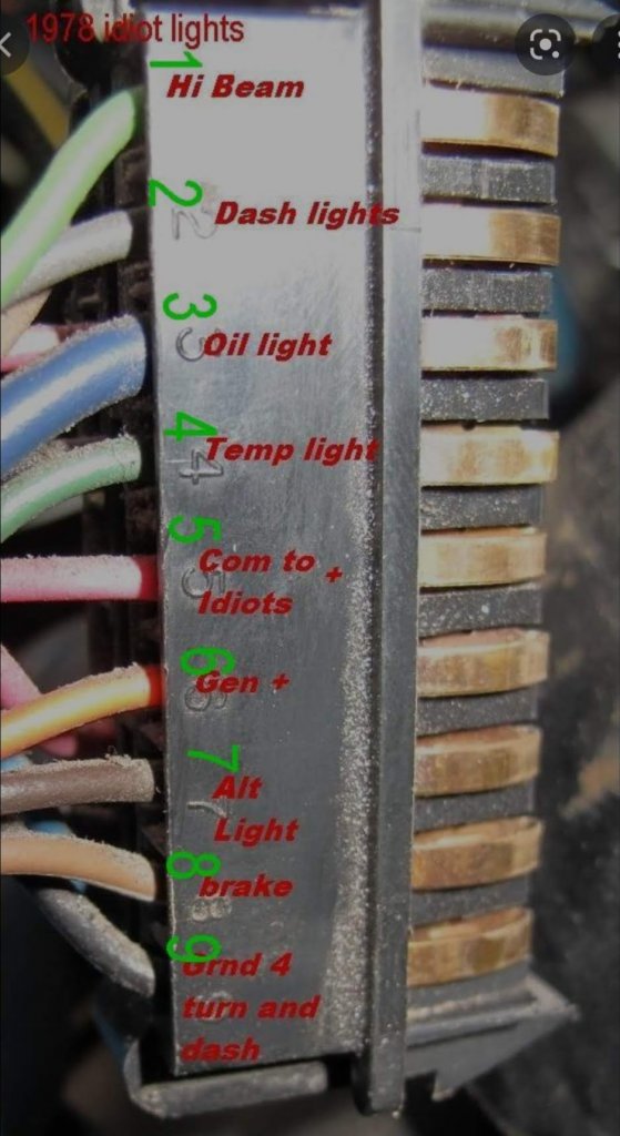

Here is some information I found useful while doing a cluster swap on my 87. I was able to combine these to figure out what everything did, as some stuff differs with the years.
I hope this helps.
-Matt

Wow! This is very helpful Matt! I’m going to use all of this. I’m curious if you know if the same wire that controlled the dummy light for temp as an example will now control the temp gauge. Or if I need to do something to change it from a dummy light to an actual gauge.
Thank you again! I appreciate this!

I would think it would work because the old sender on my full cluster had a single wire, which is a signal wire. If it's the same wire that runs from your coolant temp sender, I believe it would work.

With both clusters, you can just trace the printed circuit board and see which wire goes where. Using the wire diagrams that both @Matthew C and @Big Ray posted plus your printed circuits you can see where each wire needs to be.
You will need to replace the temperature light switch (sensor) and the oil pressure switch with gauge sensors.
Remember your truck has two oil pressure switches, one for the pressure light or gauge, the other one for the electric choke. The choke has two wires.
