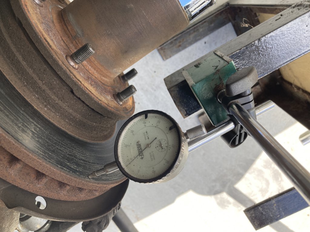

Put a dial indicator on the rotor and when rotating it was 004” or 0.100mm out both side. Would this be enough to cause the shudder? Got access to a lathe if I have to skim them. But don’t want to take them off if the runout is acceptable.
4,224
6,192
Okay I just went and read your original post I don't think the problem is rotors,82K is hub and hat I believe, yes yours are out of spec but only if you had the rotors torqued evenly and made sure there was no dirt/rust in between the hub and the rotor. Dress the hubs and the rotors torque the rotors and check again.but the cab bobbing up and down .004 runout on a rotor not the cause. Imho.
