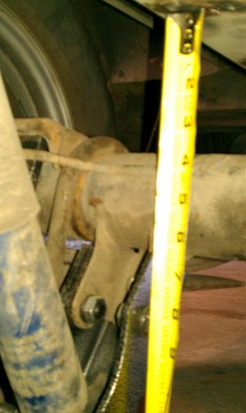

If you got fab skills, go for it. This is what they look like on the truck to give you an idea how long they need to be.

Thanks J Knight. Looks like they lower the shock 3" to 4"? Sound right.? I'll keep you up dated and try to remember to take pictures.

I would say right at 4in.

Just make sure when you lower them, you keep them higher than the edge of the wheels. This is to prevent the rear of the truck from pulling hard to one side if you have a blowout.
Since you have a welder and fab tools, I suggest you just mount both shocks behind the axle at a <10 degree angle. A little more work, but the more vertical the shocks are, the more effective they will be.
Think of it like this. If the shocks are mounted 90* to the axle(aka vertical), they are 100% effective. Now if the shocks are mounted horizontal to the axle, then they have 0% effectiveness(if that's even a word, lol). Now let's meet in the middle and mount them at a 45* angle. Now they are 50% effective. So you see, the closer to vertical you mount the shocks, the more effective they will be. Good luck!

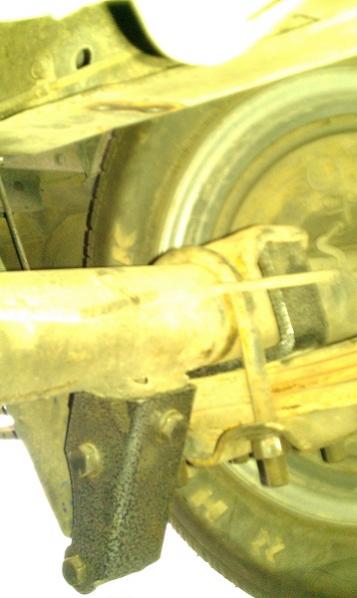

Cheater
Rusty1
Nov 15, 2012
31
Washington
Rusty
GMC C10 SWB
extensions
Started with some scrap 2X4
Cut in half
Marked the hole locations and bottom
Drilled mounting holes
cut lower extensions from some more scrap
Drilled shock mount holes
Welded the parts together
Painted and installed with new bolts from the local harware store.

Exellent! I like how you did those. I bet they fit better than the DJM ones I have.
