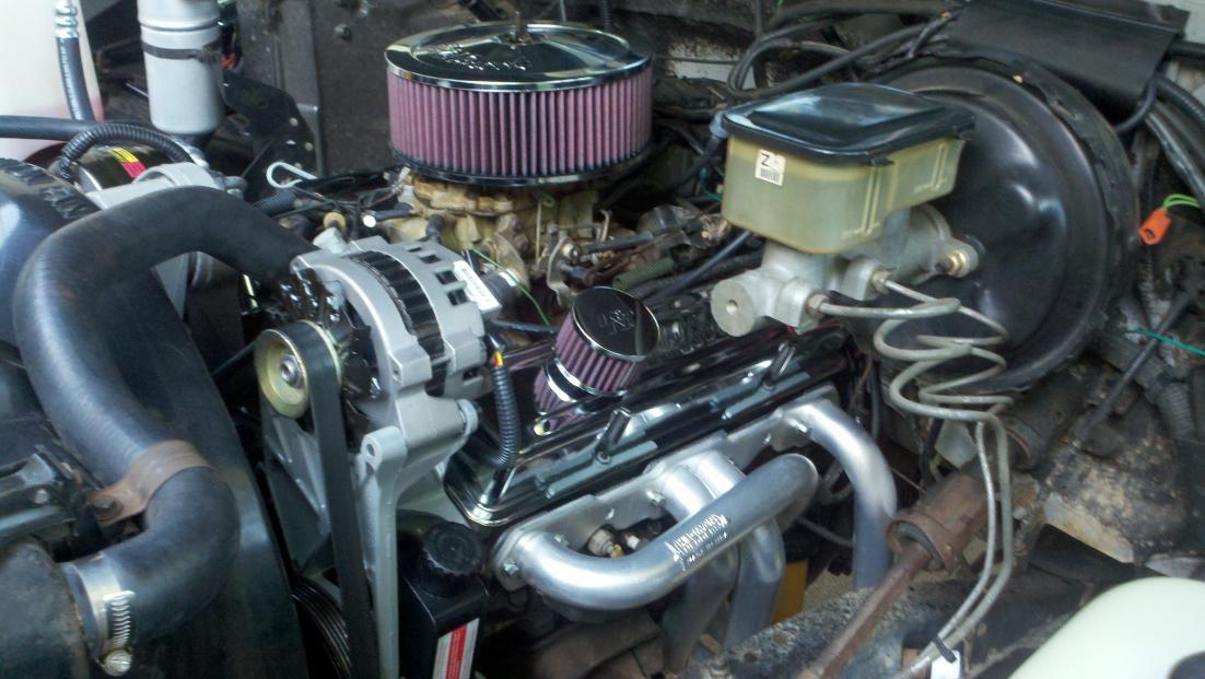

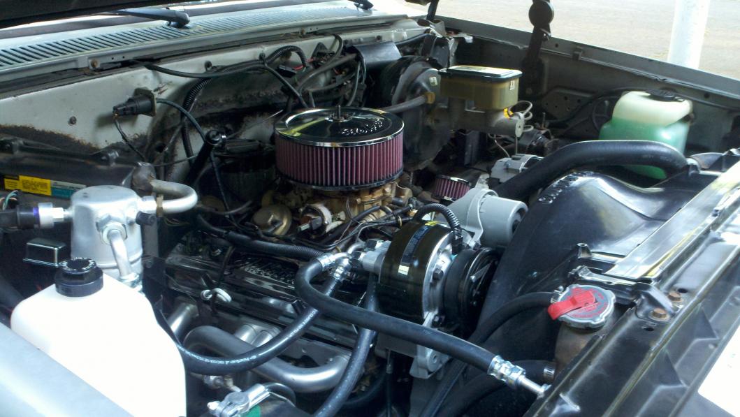

I installed these ceramic coated ones from Hedman. They are really nice. I have 700R4 and haven't had any issues with the linkage. They went in really easy for me. The right side went in from the engine compartment and the left side went in from under the truck.
Yeah those do look pretty sharp. Do you know the model or part number for them.
Those look like the first set I had, but I didn't get the coated version. When I bought new ones, I went with the other style to get them up in the frame higher, mostly to help keep them away from road salt in the winter. Somewhere around here I have a thread showing the clearance issue with the linkage.
They are Hedman Elite Ultra Duty long tubes Part# 69890 Got from Summit Racing. They do price match and Jegs was actually cheaper. But they beat the price by $5 with shipping.
