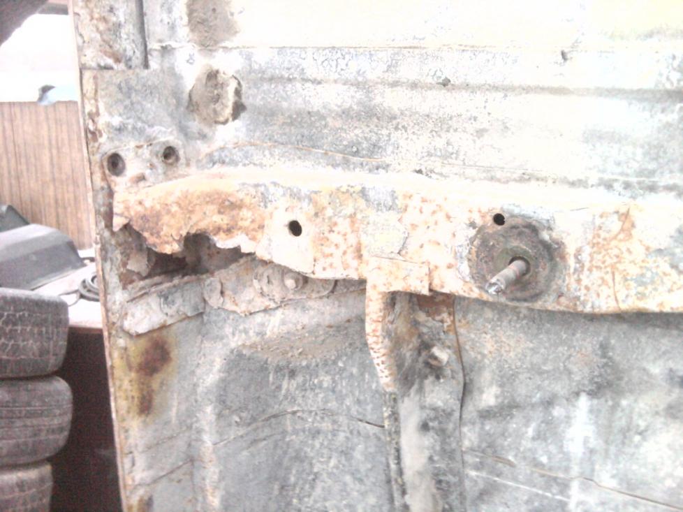

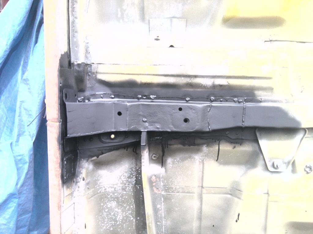

you could probably find a truck cab somewhere to cut the cowl panel patch pieces out of. or you can build what you need I rebuilt the cab mounts on my crew cab cause no one makes patch panels for them
