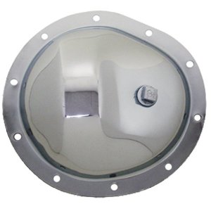

10 bolt front/rear kinda egg shaped cover 81 and up

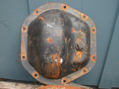

dana 44 straignt up and down side bolts 80 and older front only

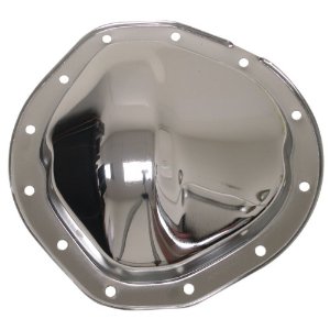

12 bolt rear 80 and older rear only

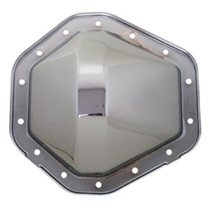

14 bolt rear 3/4 and 1 ton bolt in axle visable inside the wheel full floater non bolt in axle semi floater

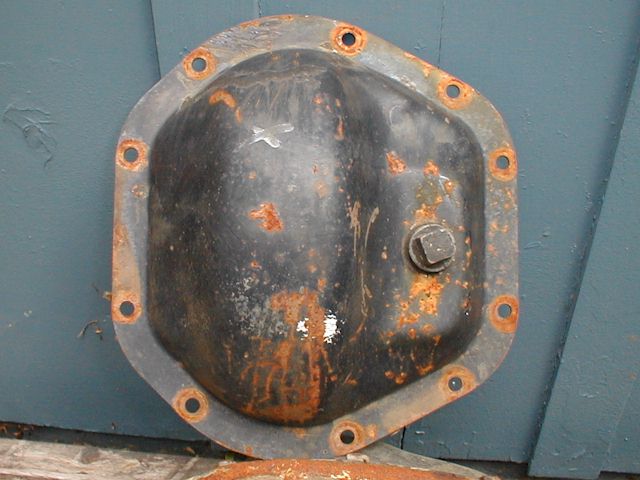

the only stock gm axles in a square i did not cover is the 1 ton dana 60 front witch the cover looks just like a dana44 but bigger and king pins instead of ball joints
