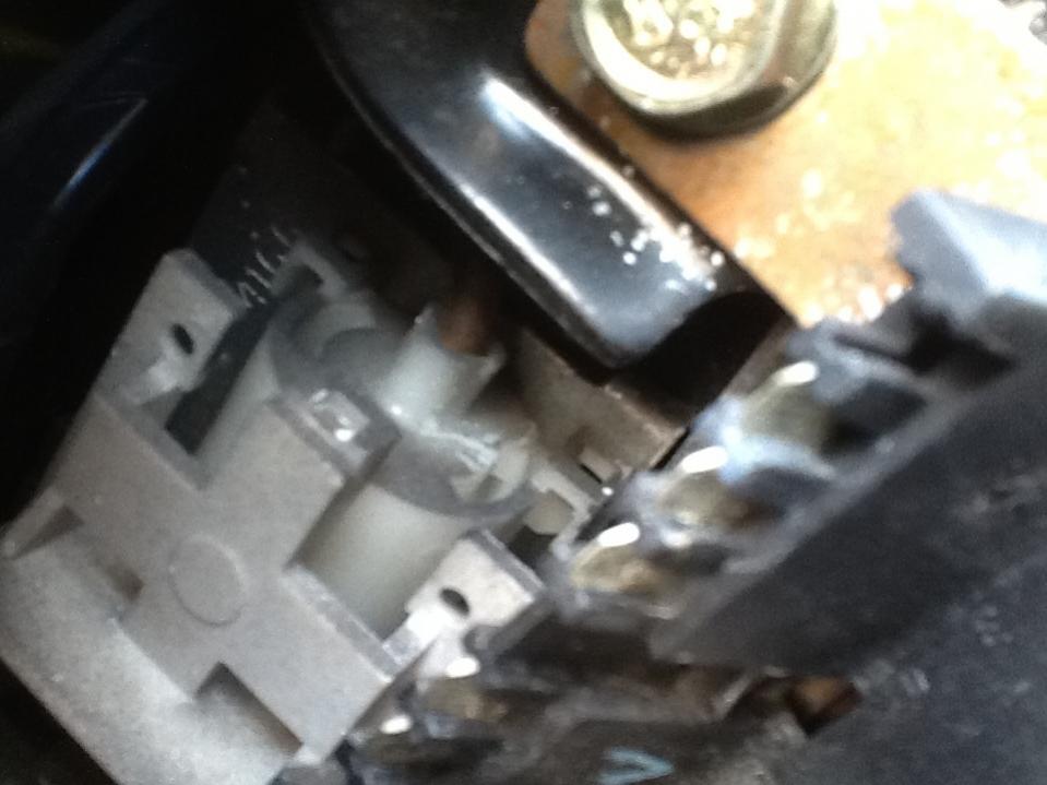

Hello all, I am having the same problem with high beams not actuating. I took off the lower dash trim and see the rod moving. It is so close to engaging the switch. I can switch it by hand. So the switch is good. The rods pushes down but is just shy of working. I see a bolt securing the switch bracket on top of the column. It looks like a pia to get to. If I loosen that can I adjust the switch back a bit and tighten it back Dow or is it a one position bolt hole?
I am trying to avoid tearing everything apart, aren't we all. The bar pushes to the point where it has a hair further to go before actuating. Any suggestions?
Thanks

Is there just a smidge of adjustment on the switch where it screws down to the column?

I can just see the top of the bolt that holds the switch assembly in place. I will have to wait to get the right size wrench at home. I'm hoping there is an allowance to loosen the bolt, slide the bracket up just a bit and tighten er up. Might be too big of a wish.
You can loosen up the bolts on it and adjust it I just fixed mine took me a little bit to get the adjustment right but it works great now I had to get a new switch because mine was so hard to push the new one works great.
