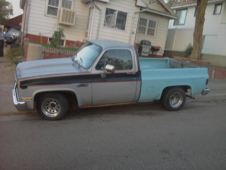

i had to trim the lips off the lower ball joint around the ball joint after installing my 3'' drop spindals on my 85

X-cabsquarebody, did 2 1/2 drop spindles lower your truck as much as shown in pic?
