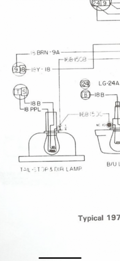

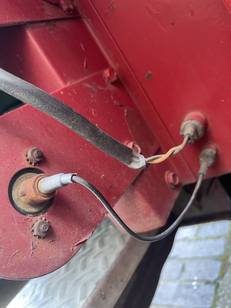

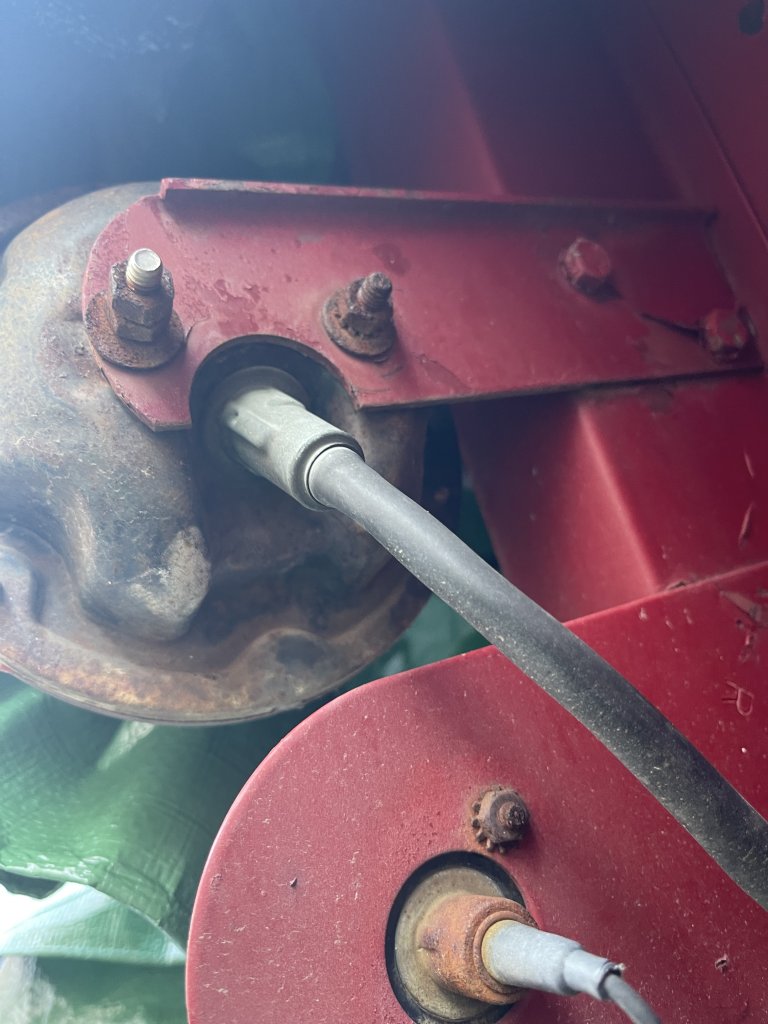

Hi i’m trying to sort the wiring on my ‘76, focusing on the lights at the moment. The rear lights i’ve connected as they weren’t connected before but i’m confused where the earth is meant to be? i can see it on the wiring diagram but there isn’t anything coming off the back of the light on either side. On the drivers side there’s a cut earth connected to the frame and just dangling so i’m assuming it had one at some point but can’t figure out where it should go

Ground the bed to the frame,the lights ground through the metal rim of the socket,but the bed has to be grounded.

ahhh ok thank you, that explains the random earth hanging from the frame! will earth it to the bed tomorrow
